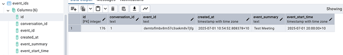

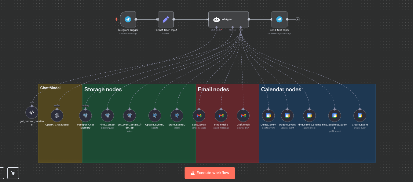

My Setup: I have a Telegram bot powered by an AI Agent node (gpt-4o model). Its purpose is to manage Google Calendar events. To allow for future updates and deletions, it saves a reference for each created event into a custom Postgres table (event_ids). This table links the calendar’s event_id to my Telegram conversation_id.
The Core Problem: After a long chain of tool calls (checking for conflicts, creating the event), the AI Agent consistently fails to use the correct conversation_id when it calls the final tool, Store_EventID.

  • However, when the agent later calls the Store_EventID tool, it uses an incorrect, “hallucinated” ID. We have seen it use random numbers (12345), my email address, and even the literal string user_phone_number.

  1. Most often, the workflow runs without an error message, but the data saved to the database is incorrect (as seen in the conversation_id column).

the main flow is Telegram TriggerFormat_User_InputAI Agent. The AI Agent then has many tools connected, including Find_Business_Events, Create_Event, and Store_EventID)*.
Store_EventID call might be generated with a placeholder conversation_id like “12345” instead of the real one.)*
