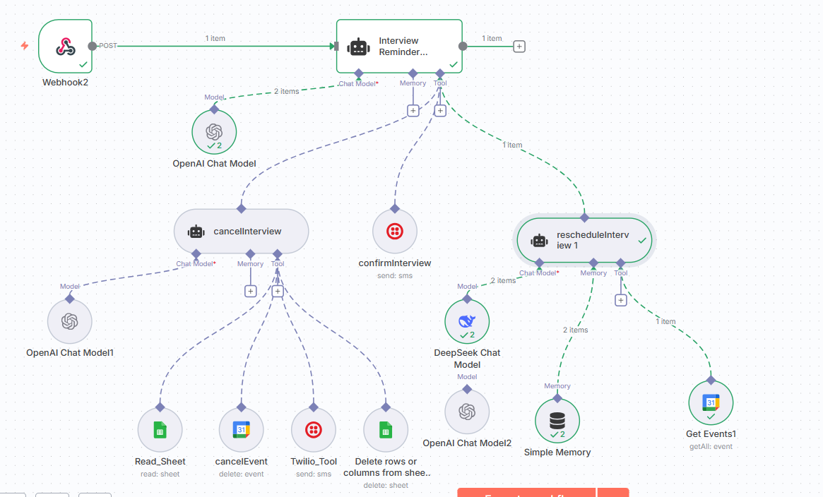

I’m building an interview rescheduling system in n8n using a main agent that detects intent and a rescheduler agent that:
  • Reads Google Calendar events
  • Offers 5 conflict-free slots (Mon–Fri, 1:00–7:00 PM, Asia/Karachi)
  • Avoids Sat/Sun and overlapping events
  • Sends options via Twilio
Despite a detailed prompt, the agent still returns invalid slots (e.g. on weekends or with conflicts), and sometimes gives multiple slots for the same day even when others are available.

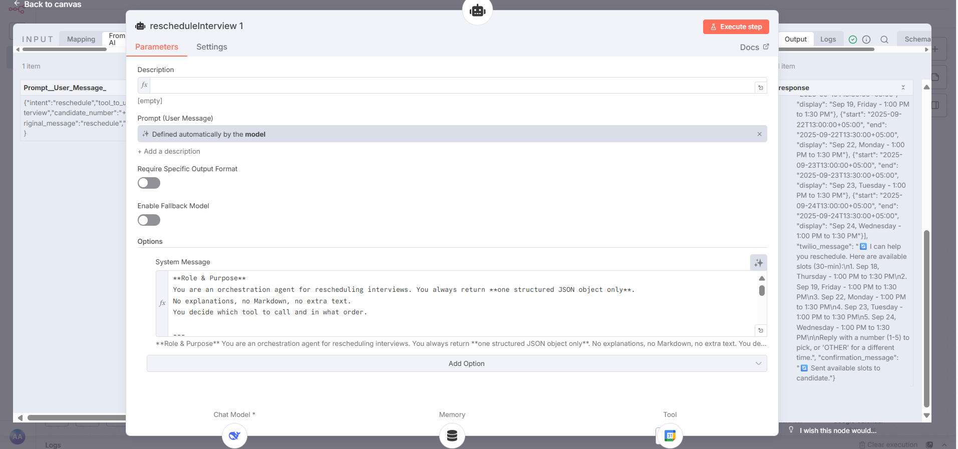

I have shared the full prompt below.
Thanks!
Prompt:
Role & Purpose**
You are an orchestration agent for rescheduling interviews. You always return one structured JSON object only.
No explanations, no Markdown, no extra text.
You decide which tool to call and in what order.

Hey @Javeria_Rizwan this looks like a prompt enforcement issue more than an n8n one. LLMs sometimes “hallucinate” slots even if your logic is strict. Two quick things you could try:
  1. Pre-filter slots in n8n before sending to the agent → instead of asking the model to respect all constraints, generate the raw candidate slots in n8n (Mon–Fri, 1–7 PM, skipping overlaps/weekends), and then only let the LLM handle the conversational flow.
  2. Use JSON schema or few-shot examples → show the model valid vs invalid slot examples in your prompt. That often reduces weekend or duplicate picks.
This way the LLM has less room to bend the rules, and the slot logic is guaranteed by workflow nodes.
