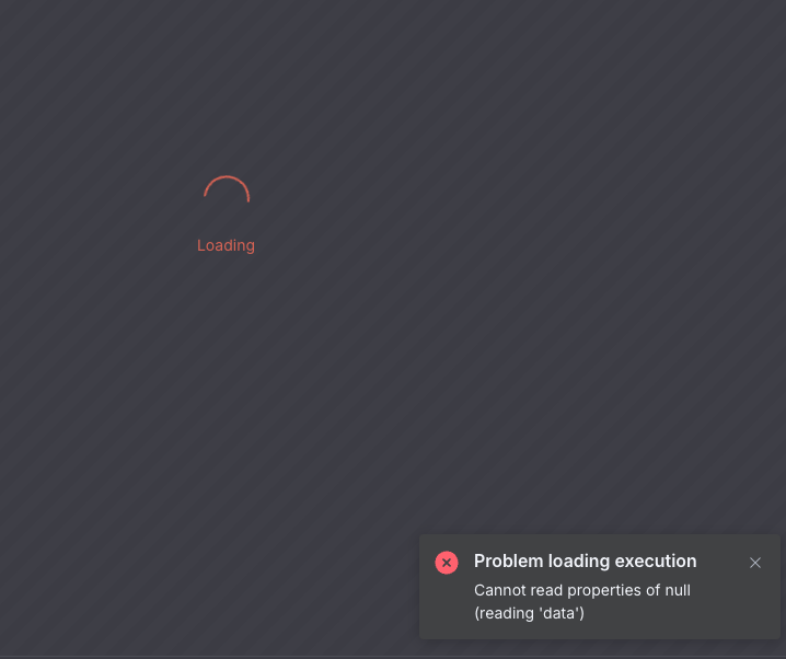

I’m facing a persistent issue with my self-hosted n8n setup and I’ve hit a wall after extensive troubleshooting. I’m hoping someone here might have encountered something similar or can spot what I’m missing.
The Core Problem: When I click on any past execution in the n8n UI, it gets stuck on an infinite “Loading” spinner and eventually shows the error: Problem loading execution: Cannot read properties of null (reading 'data'). This seems to be caused by instability in the backend, as the n8n services are constantly crashing and restarting.

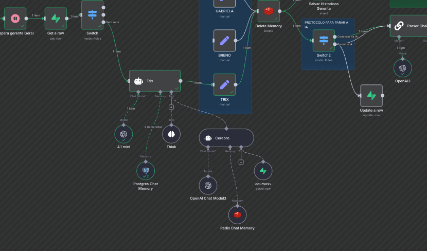

Update and a key new finding:
I’ve discovered a specific pattern for when the execution fails to load. I will provide screenshots to demonstrate this shortly.
The error occurs consistently in workflows where an agent calls another agent and the flow runs completely. These are the workflows that always get stuck on “Loading” and result in the error “Cannot read null data properties.”
In workflows where the agent doesn’t call the other agent, the workflow displays without error.
Execution ok, agent does not call other agent. When the Trix agent calls the other agent, the execution goes into error|750xauto
