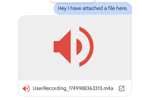

  • So yes — you can upload and send audio files, but they will appear as standard file attachments, like this:
    The user will have to download or open the file manually to listen to it — it won’t play inline inside the chat.
