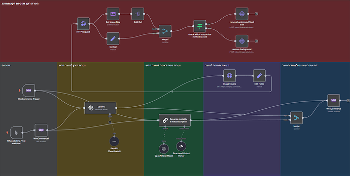

Hi everyone,
I’m trying to upload an image generated by Photoroom to WooCommerce using n8n.
The problem is that Photoroom returns the image as binary data, but WooCommerce requires a URL for the image.
I’m stuck trying to figure out how to convert or host the binary image so that I can pass a valid URL to WooCommerce.
Any ideas or guidance would be really appreciated!
Thanks in advance :pray:

instead of returning it as an image, it outputs it as a file (not in an image format)
You may need to fix the file name. Preferably in the node that form the binary entry. If not possible then try the following Code node.
What is “it” exactly in “it outputs”?
Thanks again for the quick reply – the code you shared fixed the issue! :raised_hands:
I’m still facing one problem though: it doesn’t accept the URL.
