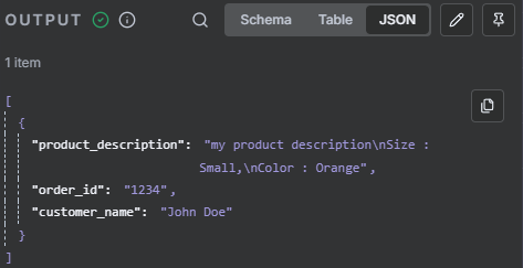

I think i got it,
hope this is what you looking for:
Yes, that’s it. Interesting solution, thanks !
In between I have also been able to do that using code node with a Javascript function which is doing a similar action.
It works but I feel that both options are a bit complicated just to concatenate strings. Simple variable management would be so much clearer and easy to setup.
Thanks a lot for your help !
