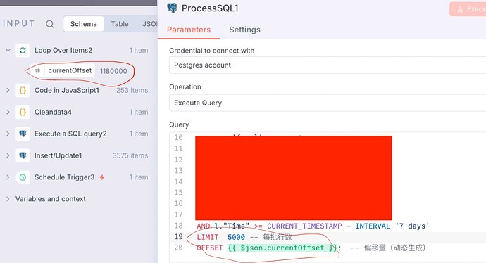

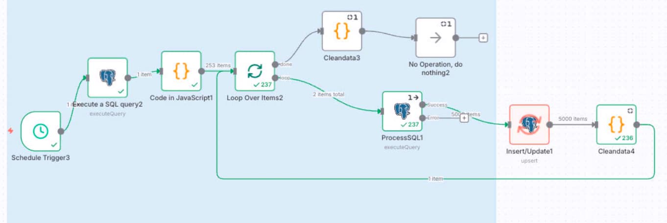

Background: Having large volume (up to millions) records to SQL query and update table (with PG). Single batch query always kills n8n memory out. thus, taking loop over items to split into separate batches, 10K or 5K per batch, count total # of records, then split into batch, using offset in sql to limit each batch numbers, i.e. Offset + limit as the record range for certain batch run
Issue facing: above loop runs well with batches within 50, but becoming slow even hang over hours while reaching batch # over 80. My guess would be, Offset + limit indexing over 1 M could slow down the workflow even with batch run.
Question: Any idea to resolve it? Thanks in advance!

Here you can find some info, but I would suggest as well using sub-workflow s, since execution releases memory once it comletes.
  • Currently, all data from each loop iteration stays in memory, eventually causing out-of-memory issues
  • The sub-workflow only holds data for the current batch in memory, then frees it
