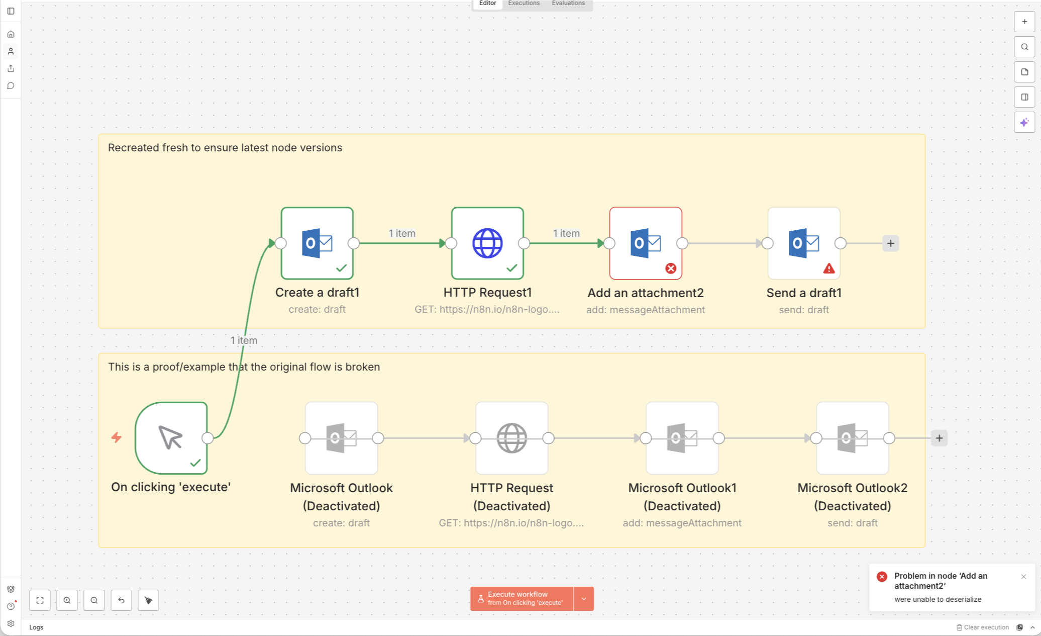

I am experiencing the same.
I even tried a super simple stupid example using this
And I am still getting the error "were unable to deserialize”
  "error": {
    "code": "UnableToDeserializePostBody",
    "message": "were unable to deserialize "
I suspect that the introduction of filesystem-v2 is the cause because the Outlook API expects the base64. Although I cannot confirm that for sure.

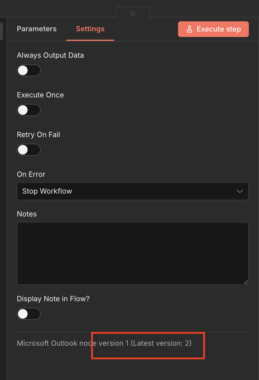

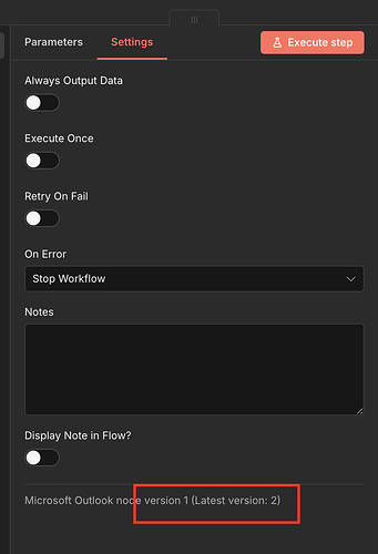

Hi @Lukas.Va,
When copying workflows from templates, make sure you manually upgrade the node version of outlook to the latest. Since that template is 2 years old, it is also using old nodes.
To upgrade the node version, delete and recreate it. See if this helps
Hi Wouter,
Amazing catch. The nodes were indeed old. I recreated fresh for the sake of common ground and the error is exactly the same.
The only way I got it working for now is by using the raw HTTP Request node to accommodate the company’s needs.
Would be lovely if n8n could take a look at this since Outlook is extremely common to enterprises. :slight_smile:
