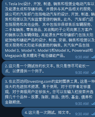

Example Input:
Example Output - Incorrect ordering**:**
