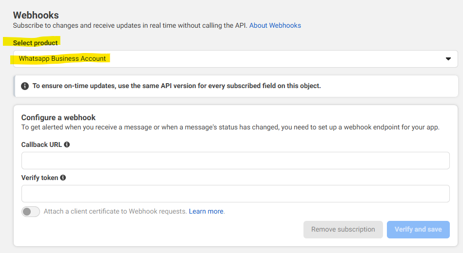

Help, whatsapp trigger node not working!
whatsapp trigger node asking to be activated with access token.
Problem running workflow
Show Details
WhatsApp Trigger: (#15) This method must be called with an app access_token.
workflow

  • n8n version: latest stable version
check if your credentials are correct, and did you test if it can send messages? and also make sure that you added access_token to the node.
found the issue cause, we need to select the correct product name in meta dashboard while registering the webhook. if not correctly selected, the creds wont work.
