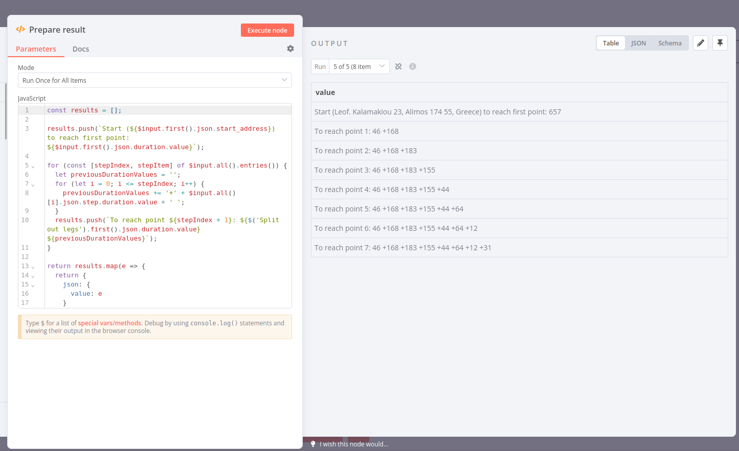

Hi @xewonder, is this actually a string that still needs to be parsed or are you working with a proper JSON object?
I am not sure I fully understand your requirement, but based on your example it seems to me that you could do something like this:
This is the result for each leg:
That said, I do not think this is a great use case for n8n as you are performing calculations not natively supported in n8n and based on the index of each item. So for the first “step” in a “leg” you’d want to take no previous “steps” into account, but for the second “step” you’d want to take the one previous step into account and so on. That’s not something n8n does out of the box, so this is not very fun to set up.
