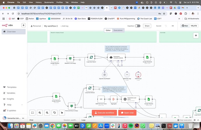

I’ve gotten myself as far as the screenshot but don’t know what to do next. I’ve created my google sheet, have my ICP created and have the LinkedIn Lead Scoring Prompt done, but I don’t know how to configure everything to work together. Can anyone help me? I’d be eternally grateful!

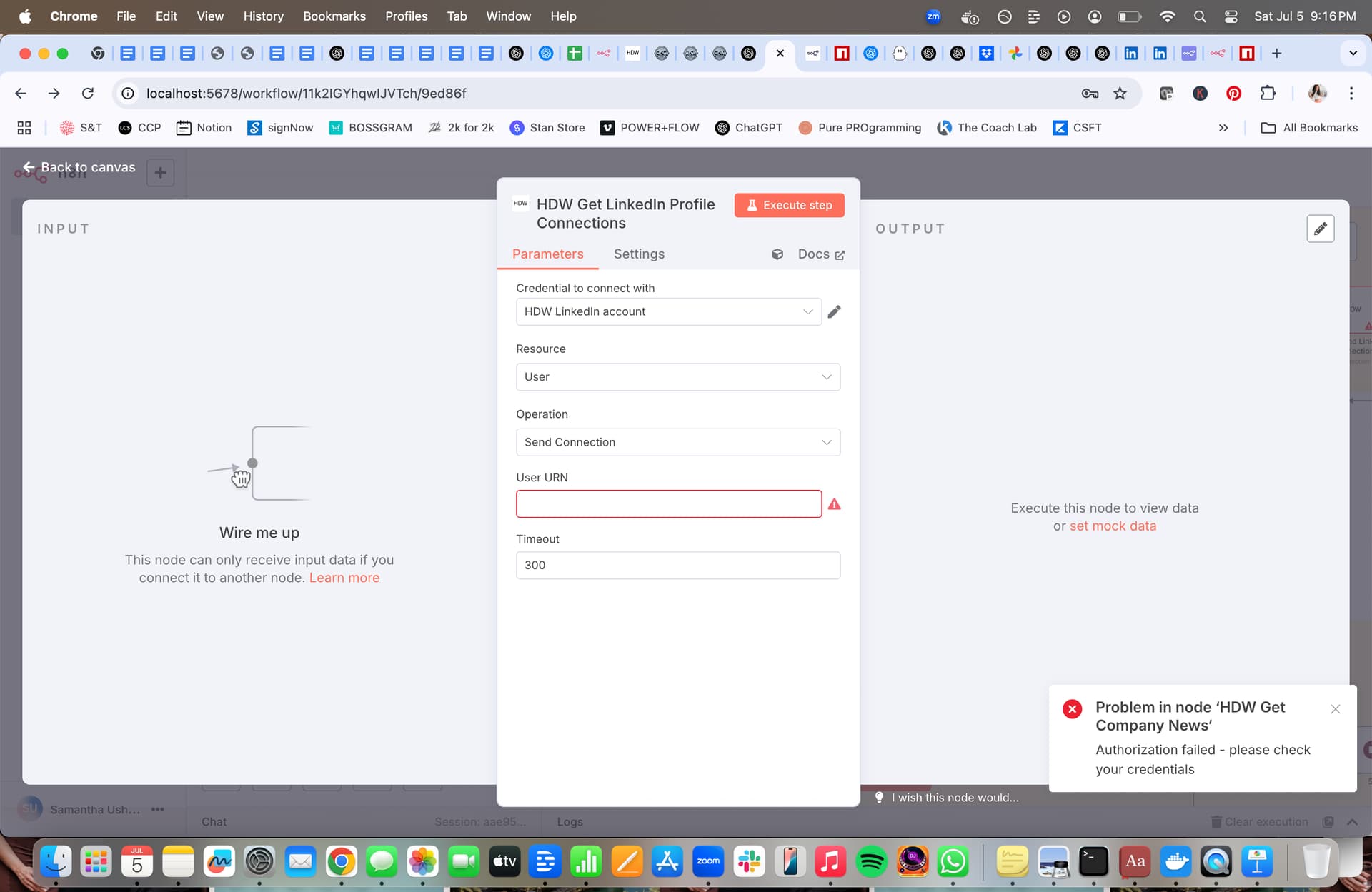

Because I keep getting errors when I try to execute the workflow
Did you install the community package?
Also, you can install it completely through n8n app.
You can follow the official instructions here
Do you know where I can find the URL and URN?
I installed the community package

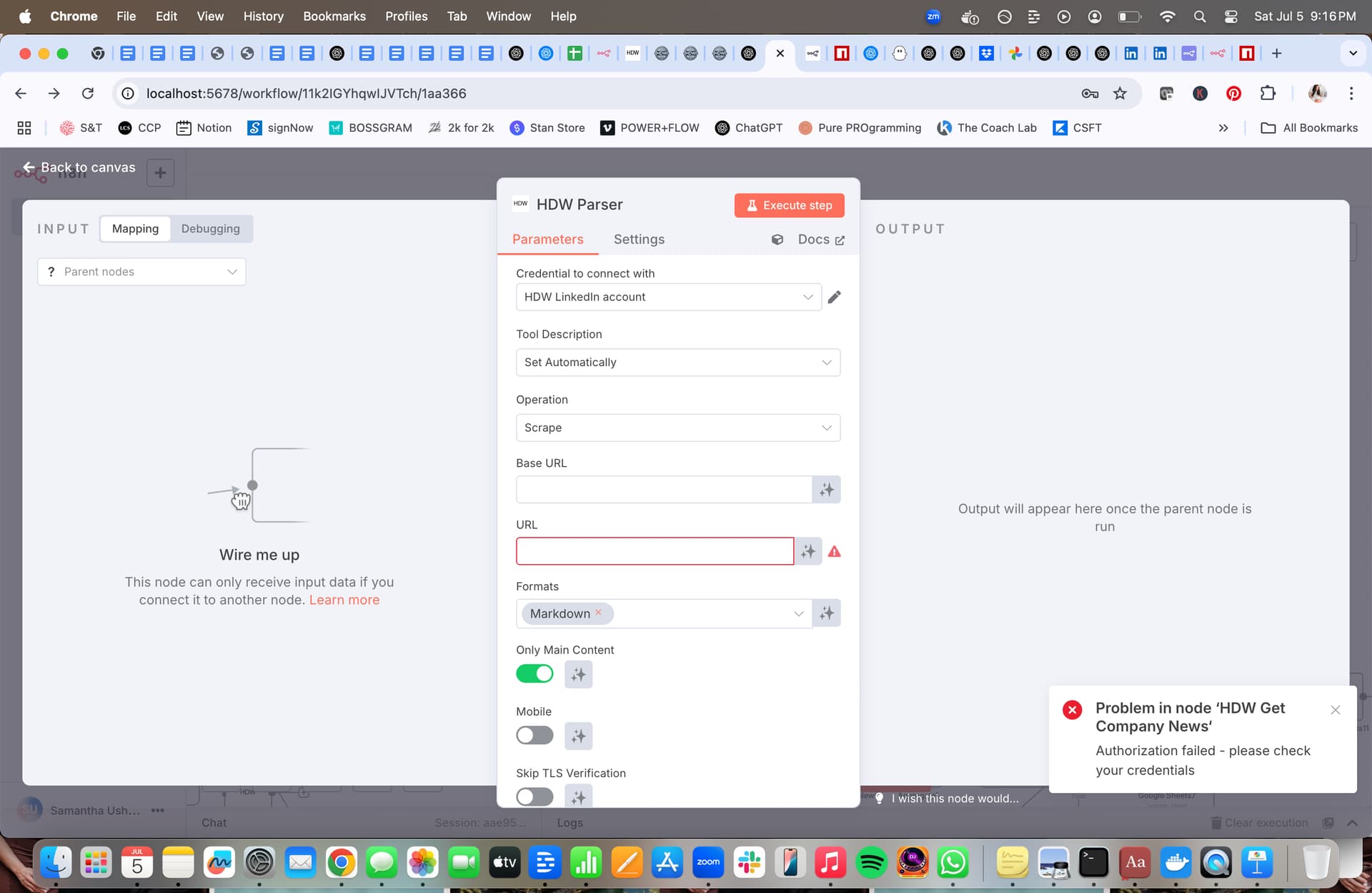

Based on the workflow page, you must setup the LinkedIn HDW key from here http://horizondatawave.ai/
I did that too, where do I input it though?
I have no Idea, but maybe you can fill with only “urn” for now and see what’s the tool doing.

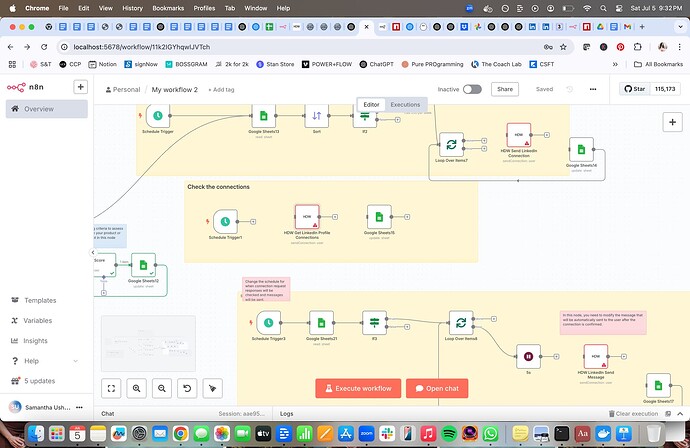

can you show me the new workflow errors?
I can’t see any error except you’ve add new node to the workflow.
If you add new node, I recommend to just change the ‘already-wired’ node that available in your workflow.
I didn’t add a new node though, I have been trying to resolve the errors on the ones from the template.
Ok, so…
the “Wire” at the HDW are disconnected, and you can connect it again. Simply hold and drag the + button in every disconnected node with HDW, then connect it to HDW node.
