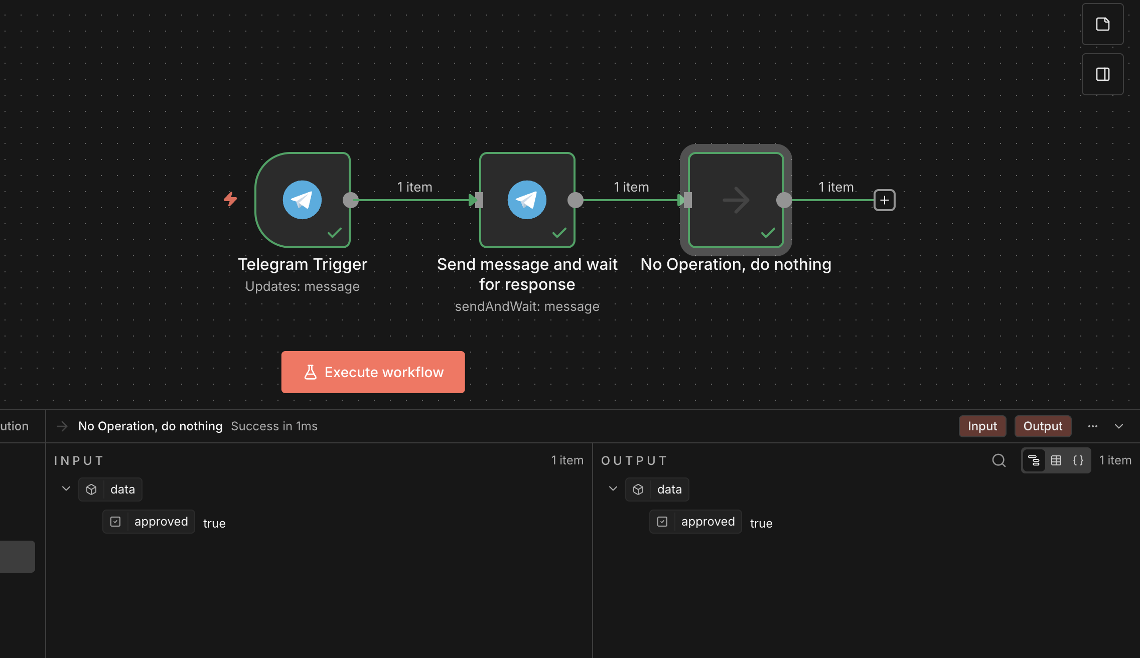

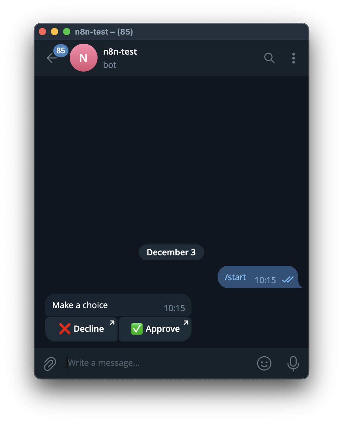

However, you can change the Operation to Send and Wait for Response, which will wait for the user to reply and then continue once they did. This option however has limitations and will send a web form url which you have to open to record your answer

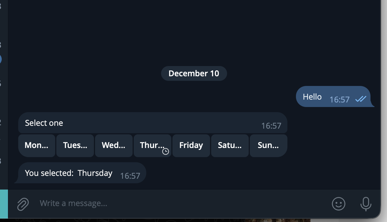

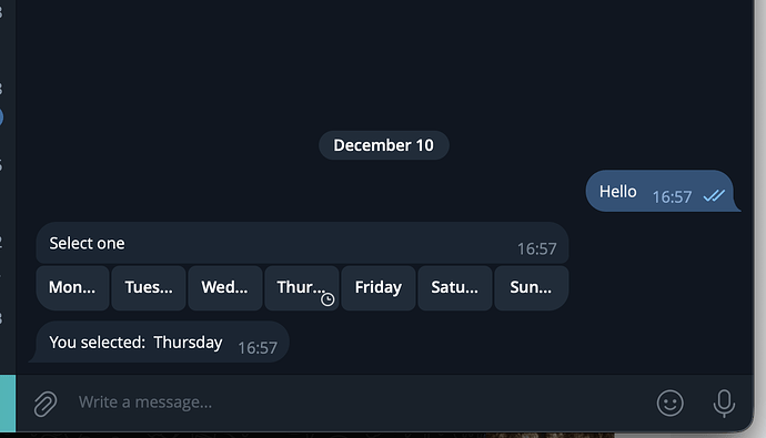

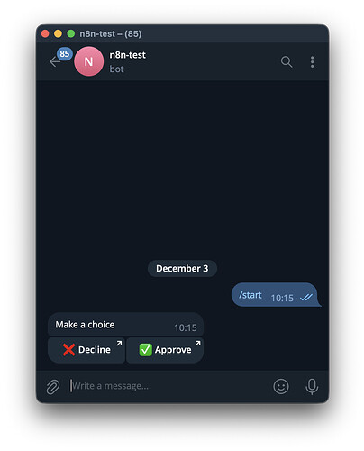

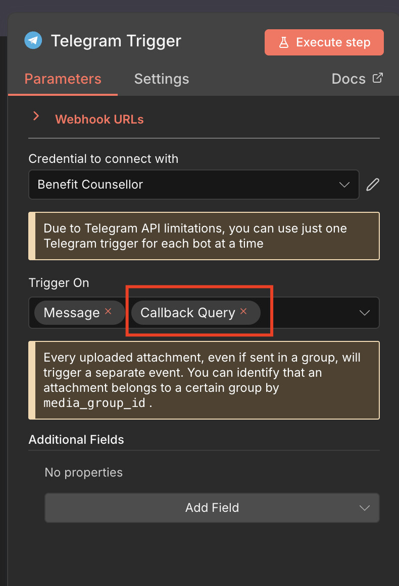

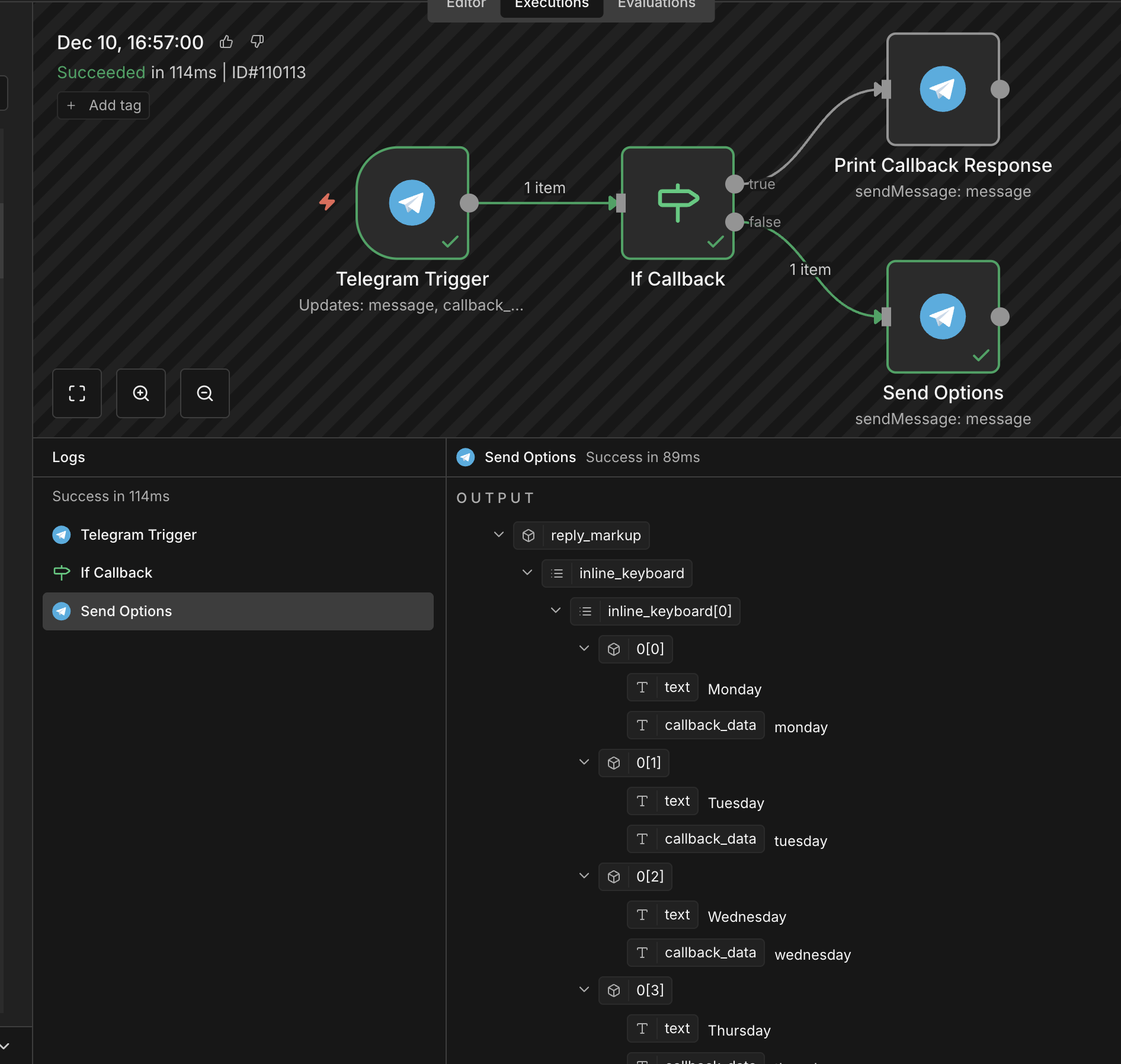

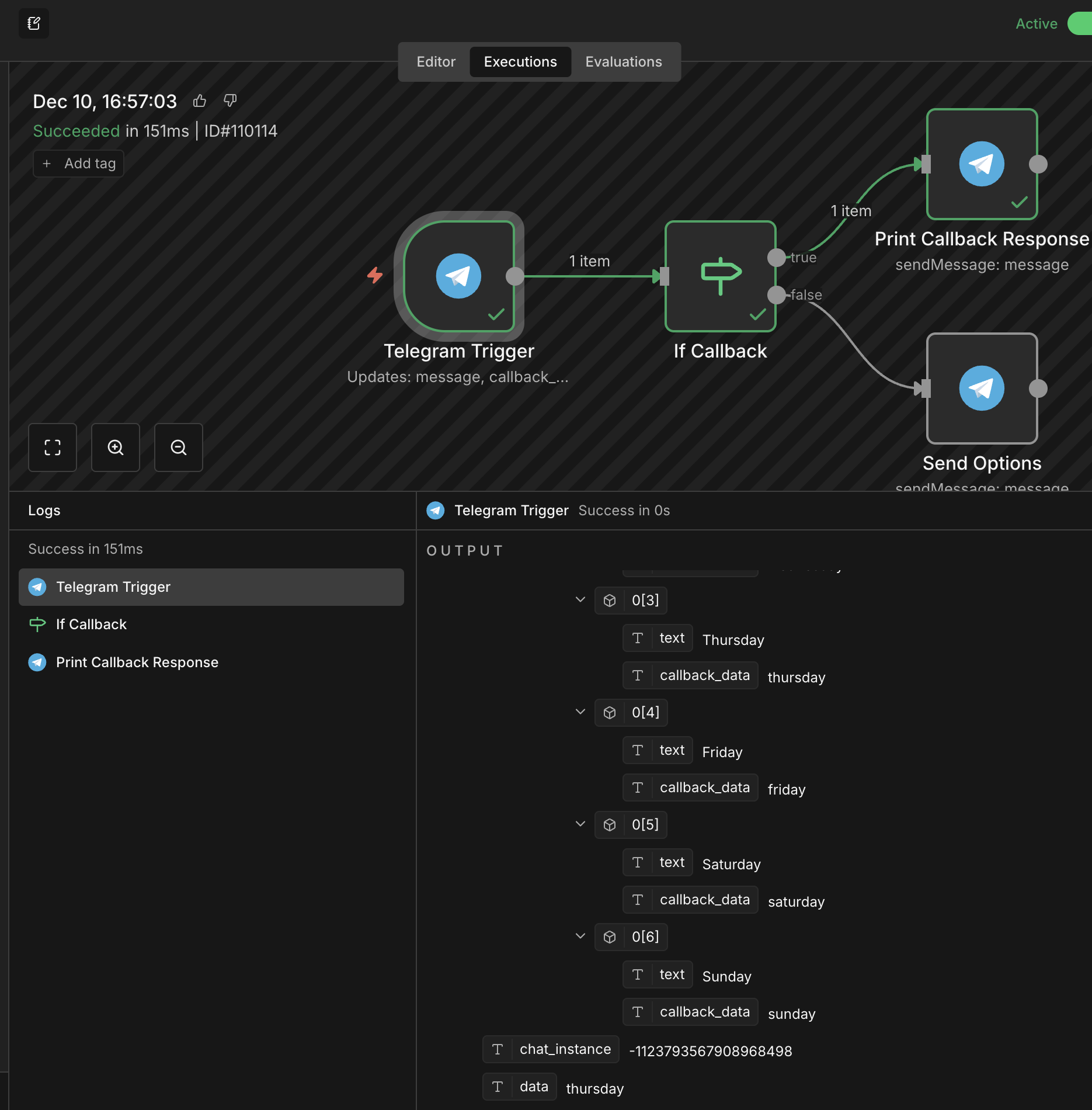

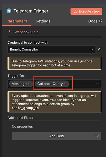

See if this helps. You can actually set the inline keyboard with options. The trick is to add the callback option to the on message trigger and then check for the response
First trigger will be to send the list of options:
Second trigger will be receiving the answer:

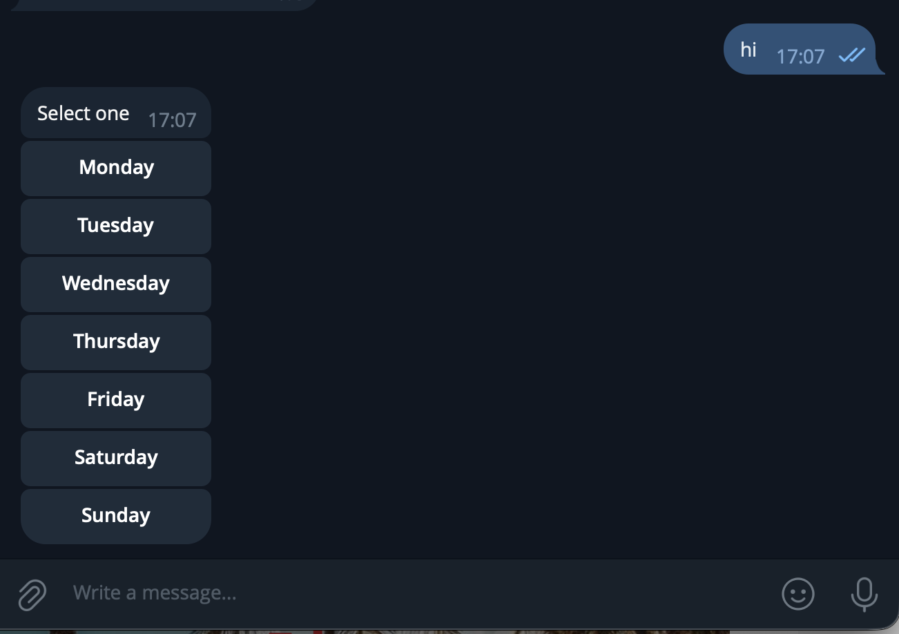

If you want to clean up the buttons and force them underneath each other, then just separate them by a row each like below. Unfortunately I believe Telegram does not support dropdowns

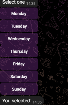

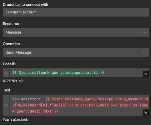

i did the same thing but why doesnt it work? Like I feel something is wrong it doesnt receive any answer
Oh yes, for the second option I sent, I never fixed the lookup for the selected option from the list. However you should see the selected value when the trigger fires again under the response which comes in. If you want it to be Pascal case, you can just update the callback_data values for each of the list options
