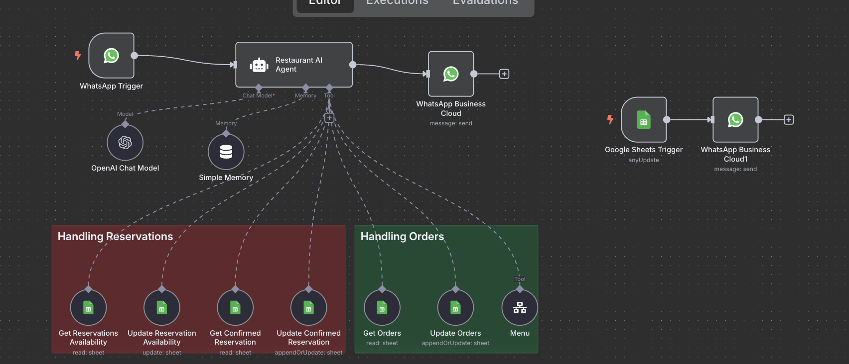

Hello everyone, currently I’m working on Ai agent that could automate the process of reservation and ordering food for a restaurant. While working on it I faced an issue that telegram bot couldn’t process several orders at the same time, it keeps mixing them up and giving wrong orders to people. Had anyone faced this issue, if yes please reach out to me.
We might need to see how you set it up.
Can you share the workflow code or screenshot?
Im sorry for delayed answer, so we thought we fixed the issue but it popped up once again.
here is the screenshot of the workflow
Is it possible to share your workflow in a code block please. Id like to see what your configuration is for the memory sub node as well as your system prompt
I think we have sold this problem by changing simple memory key from just a message to each custemers ID. Thanks for the help!
