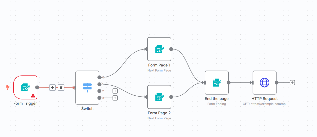

I recommend building the flow like this:
1- Initial node – Form Trigger
Select question with all three options.
2- Classification – Switch or Text Classifier
Depending on the option selected, create separate branches.
3- New page – Next Form Page
For each branch, if it requires a new form, connect a Next Form Page.
4- Form page – Form
Immediately after each Next Form Page, add a Form (a Form node, not just a Trigger). Define the desired fields (text, date, file, etc.).
5- End the page – Form Ending
In the Form node, configure a Form Ending to close that page (display a message, redirect, etc.).
6- Logical continuation – HTTP, processing, etc.
If you must make an HTTP call, wait a bit using a Wait after the Form Ending, or make a direct HTTP Request after the page.
Here is my confusion. Where is the FOrm node in item #4? I open up n8n Form, I can select End Page or Next Page. Also there is the normal Form Submissions trigger. Where is the Form page, and what is it called? It’s the missing link :wink:
Thanks for your help!
This is an example of what I mentioned to you

Thanks for that overview. But… it still just stops when going from the switch to the Next Form Page.

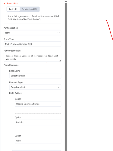

Here are the nodes I have.
This is the Form Trigger:
This is the Switch, the flow I am working on is GBP.
This is the Next Form Page it appears when running that it is waiting for something from the switch.
This is the Form Ending, which never gets launched.
I have looked high and low for videos that might explain this. It appears I am doing something wrong in the Switch as best as I can figure.
