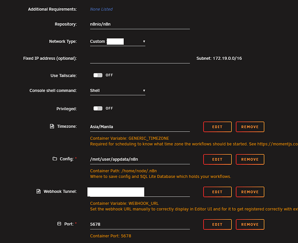

I’m using self-hosted n8n on my unraid server.
My problem is that when I use Home Assistant with the Get operation (or other nodes), the time is not the same. I have set up the n8n timezone using the env variable GENERIC_TIMEZONE.

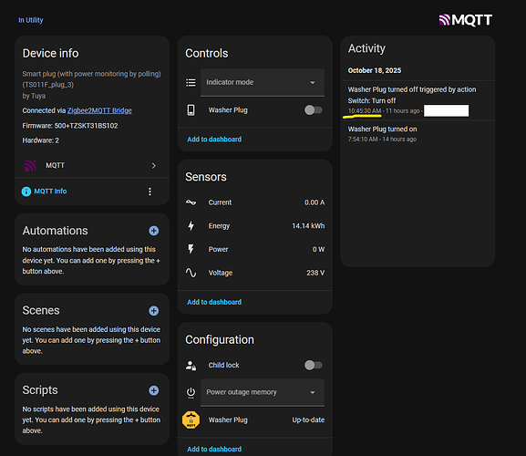

This is the time on my Home Assistant for this particular sensor:

My Timezone settings in my unraid template:

Hi @HHUBSS
It seems that the timestamp is in UTC.
As a quick fix, you can convert it to your preferred timezone, use a Set node after this Home Assistant node, and add an expression like this:
{{ $json.last_changed.toDateTime().setZone('Asia/Manila') }}
Thanks @mohamed3nan
Do you have any idea why it is outputting in UTC?
I think this is what their API returns:
