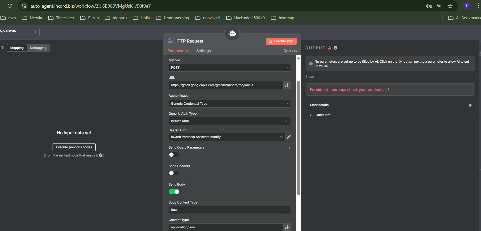

How can i create http request node to send email or create draft in gmail?
I have a workflow for send, get, reply email and i prefer to use http request node to do this. Get emails can run successfully.
But Send email or create labels can not run .
My credential is correct because i have use it in get emails.

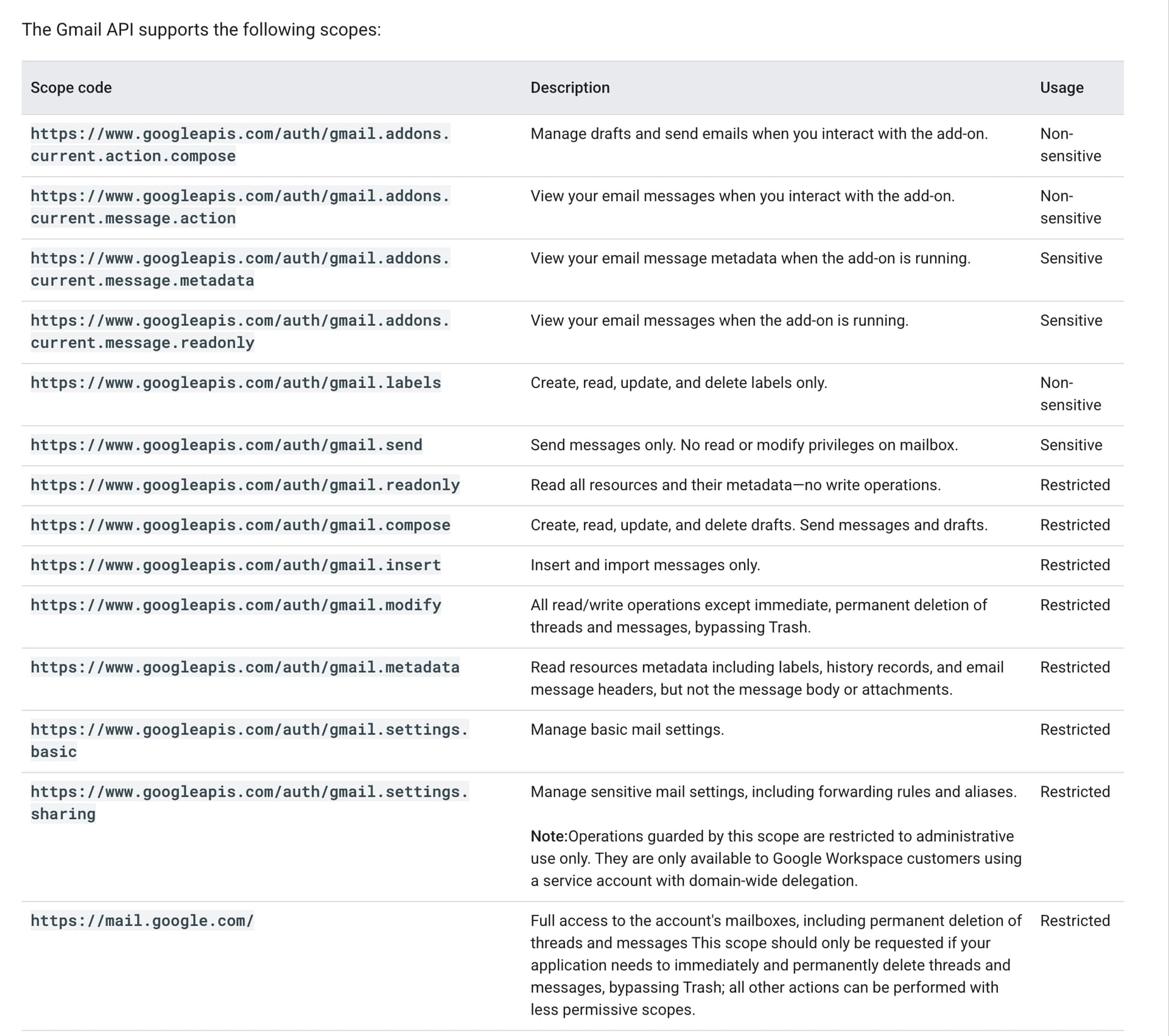

I see you using the bearer token so you are not using google oauth.
Can you confirm your api have all the gmail scopes?

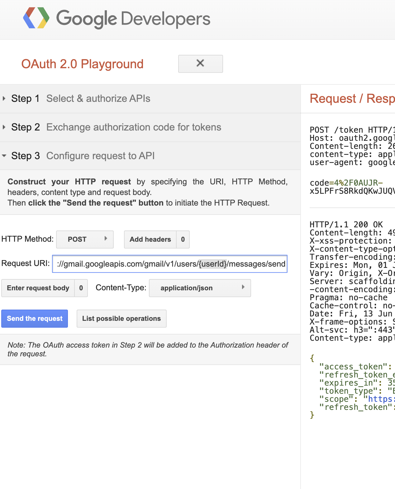

YES !! I using https://mail.google.com for full access. In my case , i want to use access token from user to authen instead of credential in n8n. Then i tried get access token in Oauth2 Playground to get it.

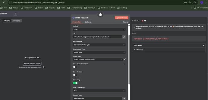

For create label
this request code works
For sending email. You might need to look into the API doucment carefully.
That work !! The problem is what i send in my body. Maybe I’m missing some fields.

I would suggest you can test the payload here first
It’s what I did for the create label.
Wow that help !!
