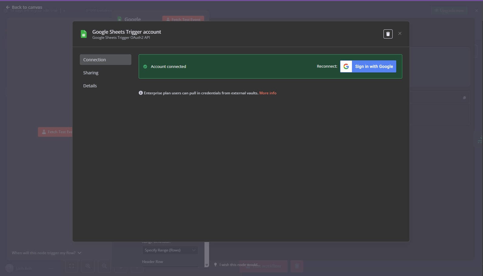

I created Google Sheets Trigger account credentials, but I can’t find the credentials data section that includes the two fields: Client ID and Client Secret to input. Instead, it defaults to requiring signing in directly with a Google account. Although I successfully signed in, when testing the event, it shows the error:
‘Forbidden - perhaps check your credentials’

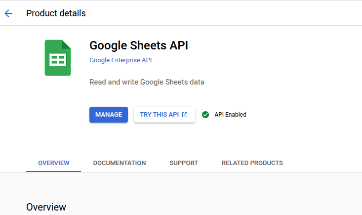

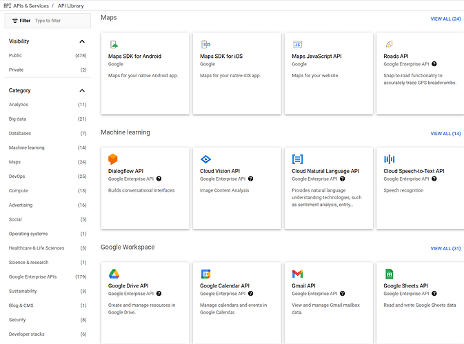

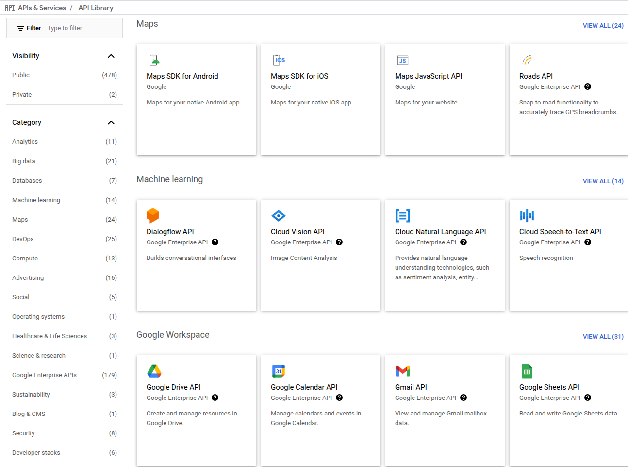

Make sure you have enabled the Google Sheets API:
  1. Go to API Services->Library
  2. Scroll down until you find Google Sheets
  3. There will be a button that either says “Enable” (if it’s not enabled) or “Manage” if it’s already enabled.
That should do it. I hope this helps.
