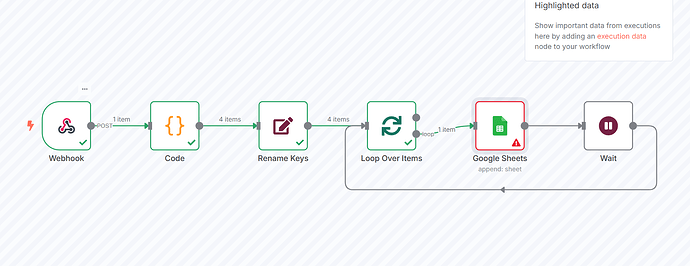

Hey, guys hope you doing well. I have a problem in my google sheet node this is a hosted in n8n. I got this error
The service is receiving too many requests from you
Quota exceeded for quota metric ‘Read requests’ and limit ‘Read requests per minute’ of service ‘sheets.googleapis.com’ for consumer ‘project_number:498586711441’.
My question are ff:
  1. how can we see the quota used when we use the google sheet node?
  2. how does the quota work?
  3. Why do we get quota limit on this workflow where we do only 4 rows append. as you can see it says read limit

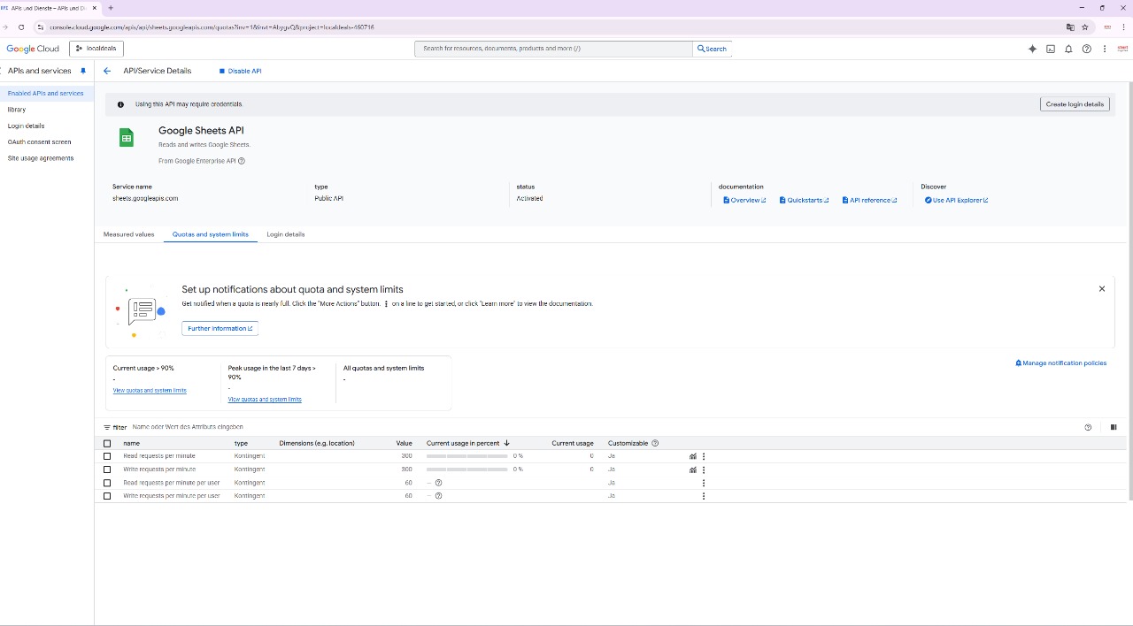

currently check the google console account of that email uses the google sheet node
I can’t see any logs here.

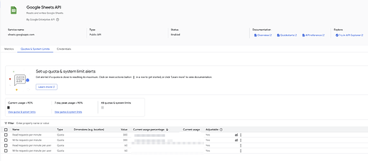

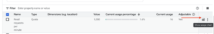

Hello Adam. In the page you just shared on the screenshot, you can click on the chart next to the three dots on the right and see how many requests you have made up to now and all the details.
Also you can ask google to increase you the quota by clicking the 3 dots .
Also as i can see , your read request is 60. per user/minute, it should be more otherwise you will have quota limit exceeded on n8n google sheet node.
In my case i am using 600 request user/ minute as i am treating a large file.

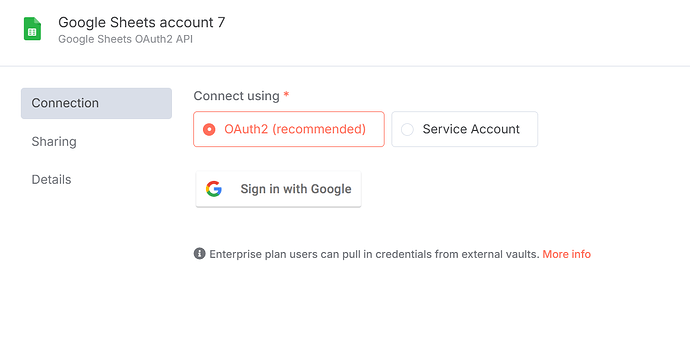

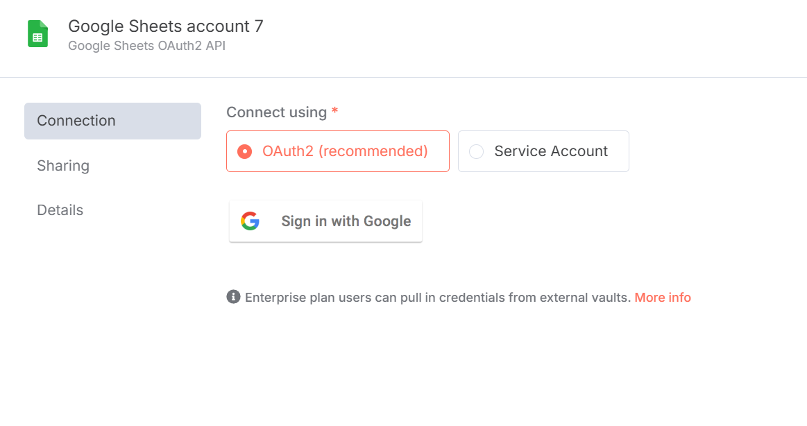

  1. Create a credentials
  2. Select google sheets OAuth2 API
  3. Connect Using OAuth2
  4. Sign in with Google
You can check the image below for your reference.
So this is independent from n8n , the error your encountring is related to your GCP.
