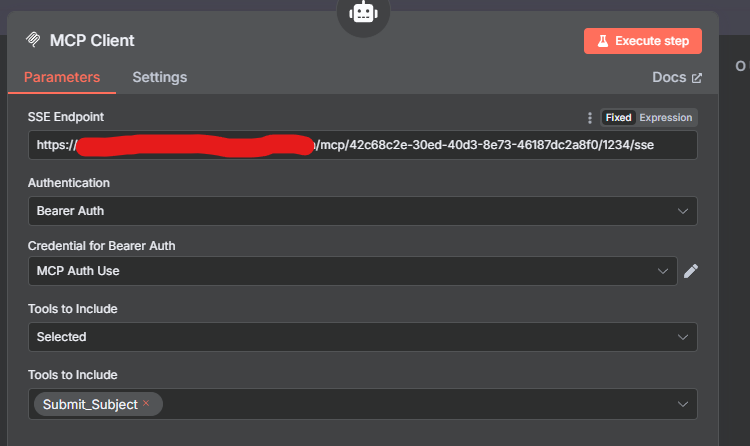

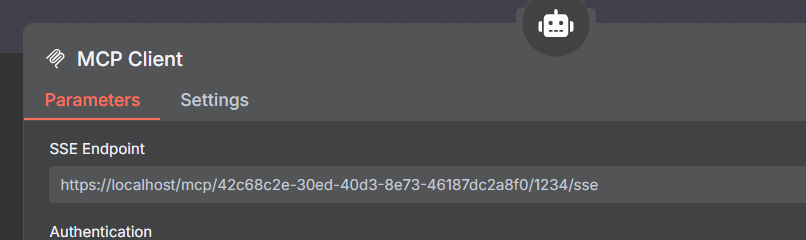

It looks like the dynamic nature of MCP tool resolution does not come through in these code examples. Here’s a screen shot of the ‘MCP Client’ tool connected to the AI Agent.

Thanks @cutecatcode, I am on 1.100.1 but was using an older version of the MCP trigger. I replaced it and I do see how the URL is differently built now. No change in ability to see the parameter value though. In the 2nd example you sent, I see you are sending a ‘url’ route parameter, but you are not using it in your Code Tool. How would you use it in that Code Tool?
Thanks!
the :url only for defining variable for mcp path variable like as what you do in /:MCPID, there’s nothing affected to related tool in MCP Server Trigger node (In my case is Code Tool).
You don’t need to add /sse path anymore in your MCP Client tool, if you already update your MCP Server Trigger node, it will give you only path without /sse route, so you can remove the /sse route from your MCP Client tool node. Hope it helps.
