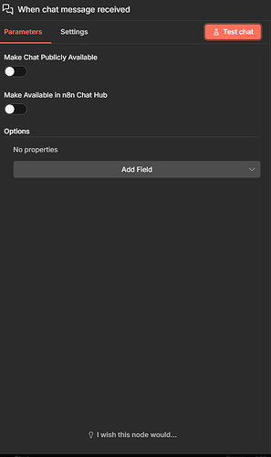

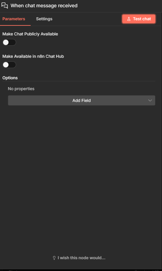

Hi @kalany
In your n8n’s chat trigger you will get an option like this:
And that option Make Chat Publicly Available just turn that on, and then the URL you will get you can embed it anywhere using an html
