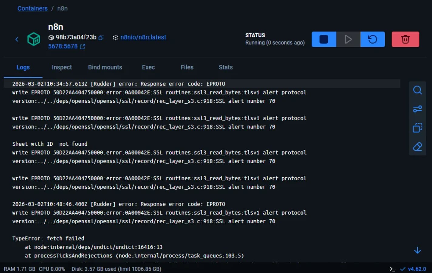

How do I fix this EPROTO error on docker?
Please help me on how can I fix this EPROTO error this happens when I execute google sheets node on a workflow

Hey , that ssl3_read_bytes:tlsv1 alert protocol version error usually means something between your Docker container and Google’s API is messing with the TLS handshake. Are you running n8n behind a reverse proxy like Nginx or Traefik or a Cloudflare tunnel? If so that’s almost certainly the culprit, the proxy might be trying to do SSL termination incorrectly. If you’re not using a proxy, try adding NODE_OPTIONS=--openssl-legacy-provider as an environment variable in your docker-compose file and restart the container, that forces Node.js to allow older SSL behavior that sometimes fixes this.
Hey this is a TLS issue inside your Docker container, try adding NODE_OPTIONS=--openssl-legacy-provider as an environment variable in your docker-compose file and restart. Also worth running date inside the container to make sure the clock isn’t off since that breaks SSL handshakes too.
Are you running n8n behind a reverse proxy like Nginx, Traefik, or a Cloudflare Tunnel? That’s usually what causes this, the proxy does its own SSL termination and it messes with n8n’s outbound HTTPS connections to Google’s API. Try adding NODE_OPTIONS=--openssl-legacy-provider as an environment variable in your docker-compose file and restart the container, that fixes it in most cases.
