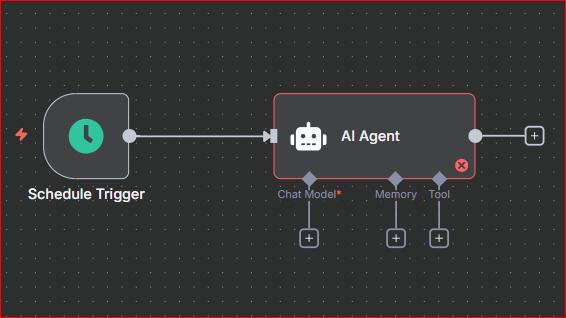

Add a “schedule Trigger” node and make it every hour in his settings.
