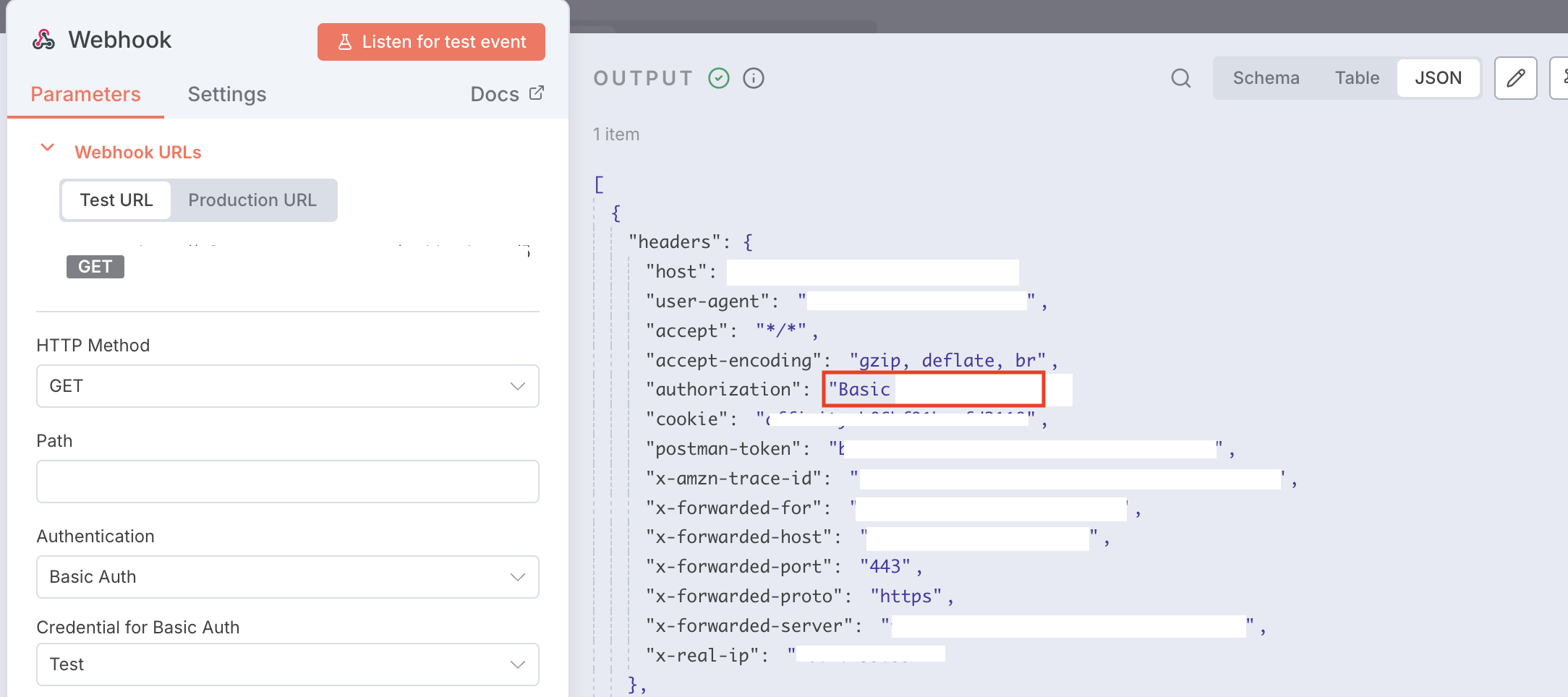

How do we redact the headers that are sent to the webhook trigger node

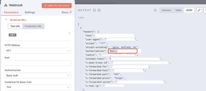

I’ve noticed a potential security concern regarding the Webhook node. The authorization headers are always visible in the output tab when the node executes, which could expose sensitive information.
I observed that there is existing redaction logic for the HttpRequestNode, but it doesn’t seem to apply to the Webhook node. Since credentials are included in these headers, it would be ideal if similar redaction could be implemented for the Webhook node to ensure better security.
Is there any way to resolve this concern ?
Thanks

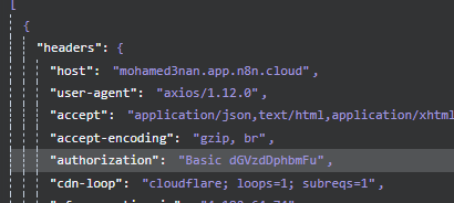

Hi @prajwal-razorpay
I believe what you’re seeing here are the hashed credentials, not the actual credentials.
@mohamed3nan It’s not really hashed - its only base64 encoded - which offers no layer of security.
My password decoded
You password decoded:
A feature would need to be added to either redact the secrets / hash the secrets like you mentioned - else this breaks the whole purpose of the credentials module.
