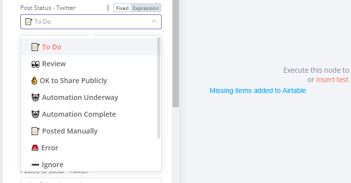

Here’s what I see in n8n for options (part 1):
Rest of the list (since there was a scroll):
Here is my list from Airtable with the missing TBD highlighted.
The TBD option was added to the list after I started working on my flow in n8n.

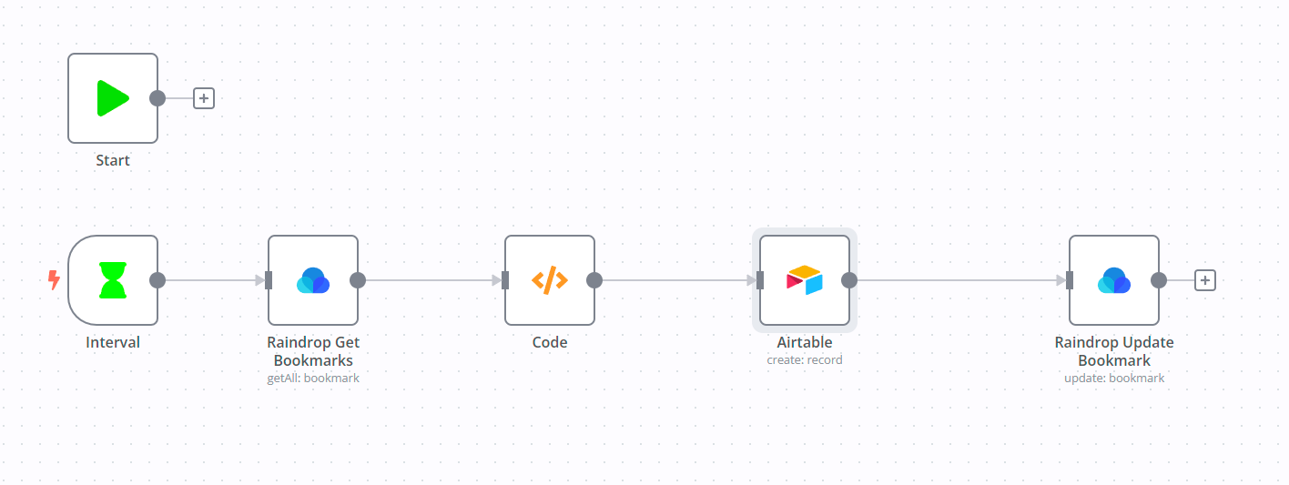

Here’s an overview.

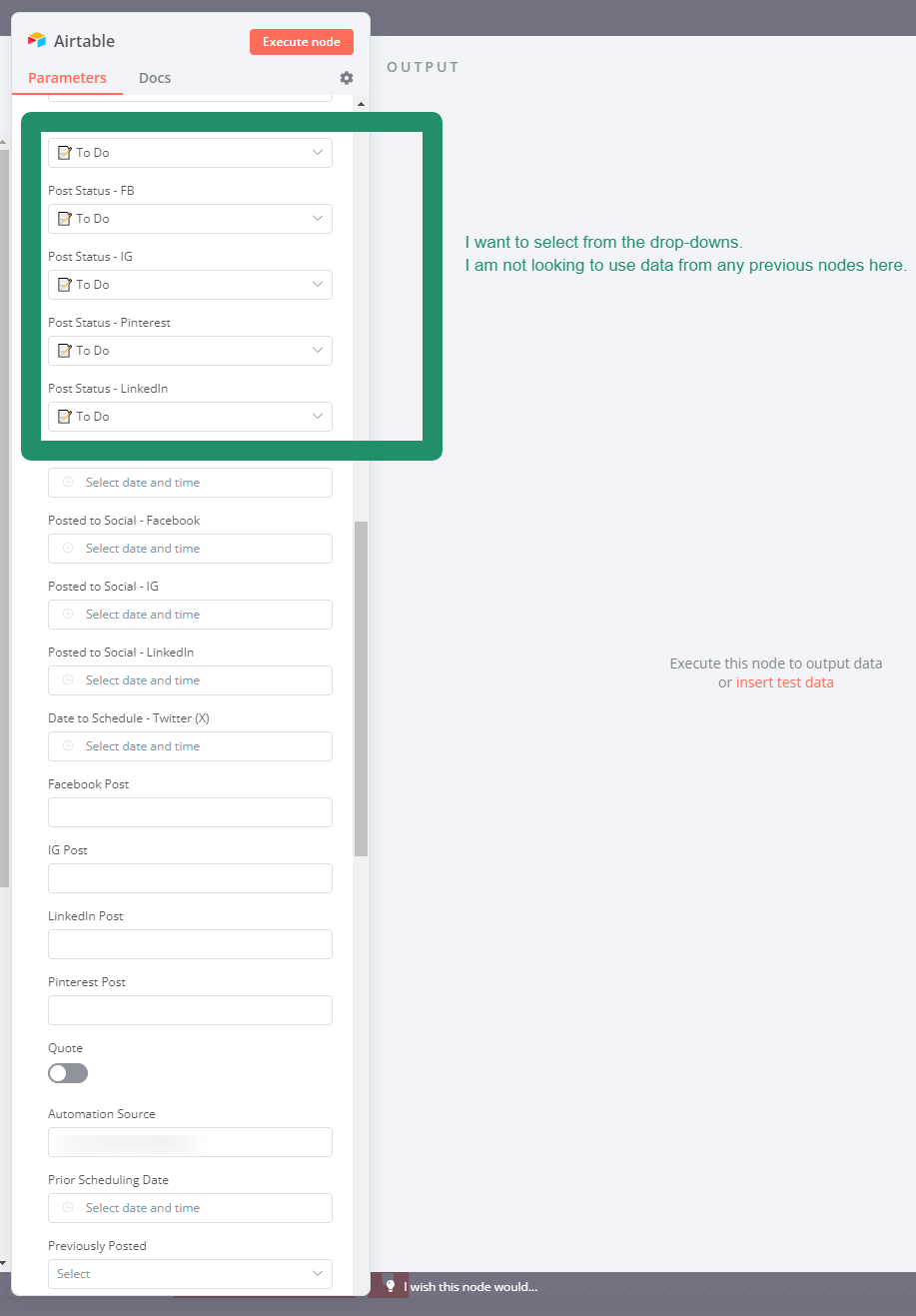

Here is a snapshot of a lower part of the node with the drop-downs that I am trying to populate. (Options shown in prior screenshot)
Is this helpful?
Hey @colleen,
That does look handy, So the newer version of the node uses a different component which we call RMC (resource mapper component) this is what creates values to send and makes it look nice.
The trick with this though is it loads all of the items at once so if you were to update something in Airtable we won’t know until you update the columnes, If you click on the dots next to “Values to Send” that should then have a refresh option which should reload the column data and get this working for you.
