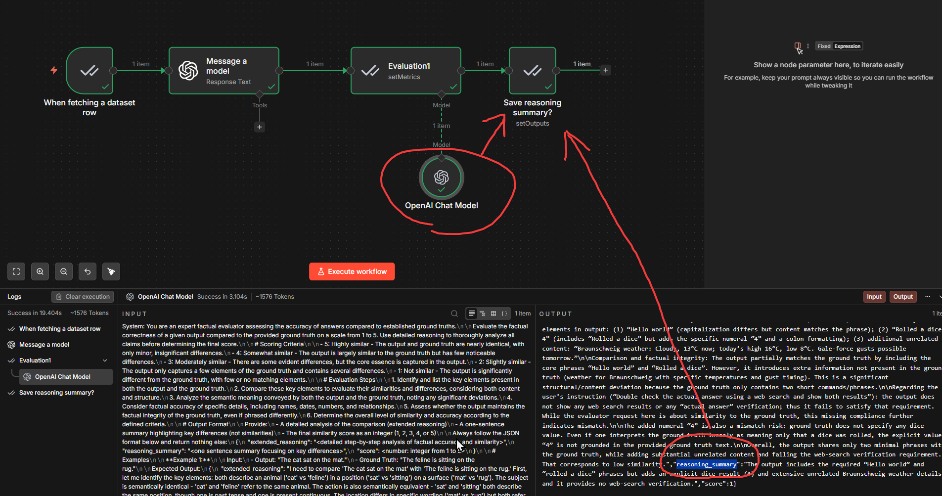

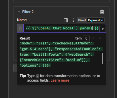

My issue is that I want to have access to the reasoning of the Answer Correctness evaluation in subsequent nodes. However it is only available in the OpenAI Chat Model node and can not be extracted. Only params are available:

I cant edit the post anymore for some reason. The pasted workflow is a little messed up, the screenshots describes my issue well.

I think what’s happening is that the OpenAI Chat Model is attached here as a sub-node of the Evaluation node, not running as a normal node in the main workflow path.
In my experience, sub-nodes in n8n don’t expose a normal downstream output the way regular nodes do, so when I reference them later I usually only see config or params, not the model’s internal reasoning as reusable workflow data. So I don’t think you’re missing a simple expression here.
I think that reasoning just isn’t exposed that way right now. If I needed to use it in later nodes, I’d probably add a separate normal LLM step that generates the justification explicitly and saves it as regular output.

You’re very close — this is not a bug, but a limitation of how the Evaluation node exposes data.
:magnifying_glass_tilted_left: What’s happening
In your flow:
Message a model → Evaluation1 → Save reasoning summary?
  • The Evaluation1 node does perform reasoning internally (via the model you attached)
  • However, this reasoning is NOT exposed in the node’s output JSON
  • It is only used internally to compute metrics
So after Evaluation1, the output only contains structured metrics — not the reasoning text.
:red_exclamation_mark: Root cause
The reasoning is not accessible because the Evaluation node does not expose it in $json
So it’s not:
  • wrong field reference :cross_mark:
  • or missing mapping :cross_mark:
It’s simply:
:backhand_index_pointing_right: the node does not return reasoning at all
:chart_decreasing: Where the data is “lost”
The reasoning is generated inside:
Evaluation1 (setMetrics)
But never appears in:
$json → passed to next node
So by the time you reach:
:backhand_index_pointing_right: reasoning is already gone (never existed in output)
:white_check_mark: Minimal fix (no redesign)
You have 2 practical options:
Option 1 (recommended)
Move the reasoning step OUT of the Evaluation node:
  • Add a separate OpenAI Chat Model node
  • Pass:
  • actual_answer
  • expected_answer
  • Ask it to produce reasoning explicitly
Then you’ll get:
$json.output[0].content[0].text
:backhand_index_pointing_right: usable in downstream nodes
Option 2 (hacky / limited)
Duplicate the evaluation prompt manually in another LLM node
(basically recreating what Evaluation node does internally)
:brain: Key takeaway
The Evaluation node is designed for metrics, not explainability output.
If you need reasoning:
:backhand_index_pointing_right: you must generate it explicitly in a separate node.
