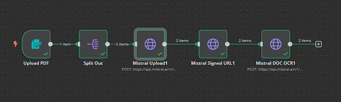

I’ll explain, I want to upload multiple PDF at once, read every PDF files with Mistral OCR and ask an AI Agent if my folder is complete and if any PDF is missing based on a prompt.
The workflow is working well if I upload only 1 PDF. But I can’t find a way to make it work with multiple PDF… I read on some topics that we can split our 1rst result with one section of code but still got the same error with the code.
“This operation expects the node’s input data to contain a binary file ‘data’, but none was found [item 0]” when reaching the first Mistral Upload Node.
Here is my workflow :
Thanks

Hello @Octek Welcome to the community :tada:
Can you try this
it should work with multiple uploaded PDFss

If you don’t want to use code, here is a very simple approach:
This setup splits the binary files:
and this correctly maps the input data field:
Oh great !
That’s working !
Thanks a lot for this, I think this trick is a “must have” for everyone working with multiple files at once !
Again, Thank you !
