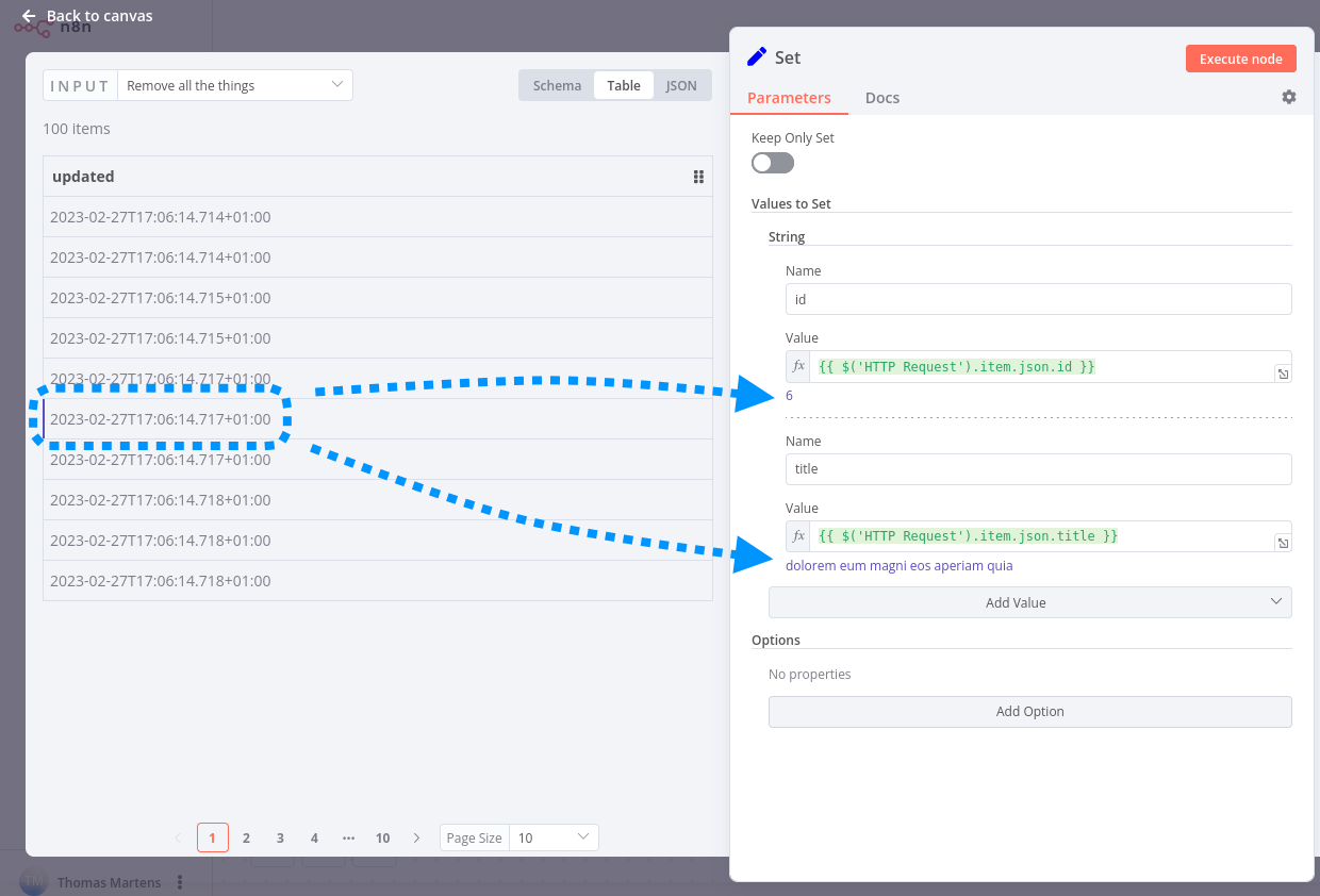

2)How can I use the UI tool to diagnose this better? That is, how can I see what the expression evaluates to for the 10th, 100th, 1000th item in the input?
I’d simply use add a Set node before your IF node and use the expression in the Set node. You can then easily see what your expression returns for every single item.
3)If I’m looking at the 1000th item in the input, how do I see the values of nodes immediately prior that are linked to that input? Specifically, how can I check which field key it’s testing?
You can simply hover over the item you’d like to show a preview for. The preview will show up just below your expression. It’ll change for each item you hover over:

re my question about looking at how different inputs are being used: I discovered the “hover” feature afterI posted. Thanks for that. Does that only work on the immediately prior input? If I go further up the chain, can I hover over a SQL row (in this example) and see how it’s rendered by the module?
