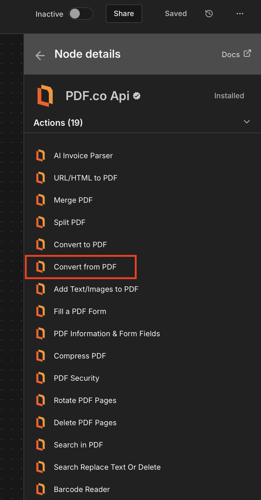

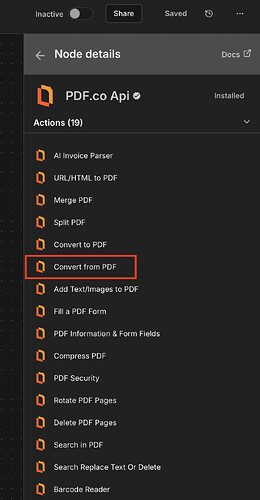

Hi @polyglot_engineer, if you’re willing to pay for a service to do this, you can install the pdf.co community nodes and then pay for the service to convert it to image for you. This will be your easiest solution
To install the community node, search for “pdf” in the right hand panel, select pdf.co and click install

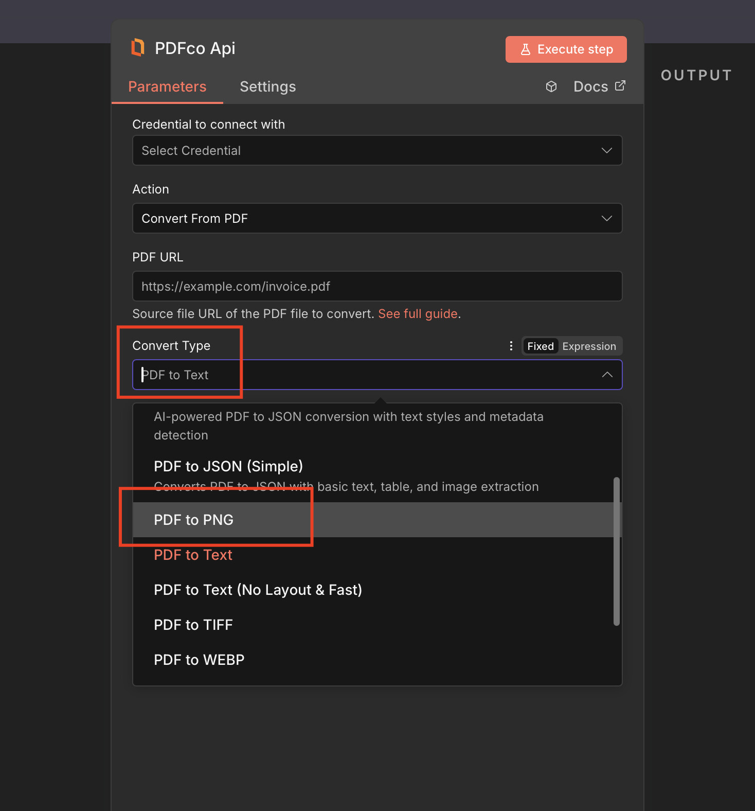

once installed you should be able to convert pdf to images to store wherever you need using
Then select the type of image
PDF APi Hub Node Provides this , PDF to PNG, it also has node to extract text from scanned pdf documents using OCR.

You Can Paste PDF URL or Binary Data
