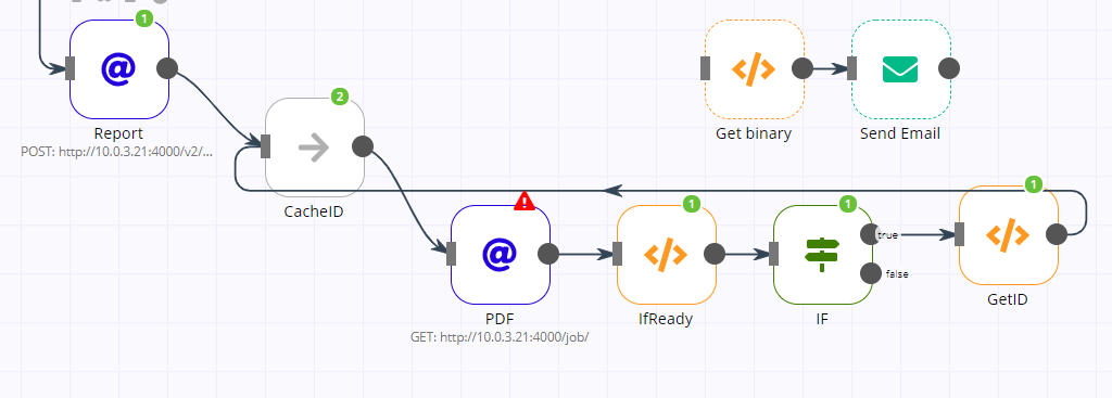

Okay cool. I got the ID cached now - seems to work like this:
But now the error is that I’m missing an Authorization header (which also gets aquired in another step prior to this).
