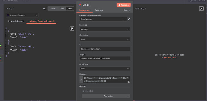

However, the end goal is to send an email on a daily basis that indicates when the two systems are not in sync. The problem I’m having is I can’t figure out how to take the output from the compare datasets node and send a single email with are out of sync.
The screenshot is of a Gmail node with the input to it on the left. The message body will be boiler plate with the variable section listing the animals that are out of sync. Something along the lines of this:
Duke: OKAN-A-670
Nala: OkAN-A-489
I read that I can’t do a for loop in an expression, so my guess is that I will need (at least) another node between the compare dataset node and the Gmail node. Maybe a code node?
I tried it with an aggregate node, but that just moved the problem.

It’s not exactly “looping” but you can do what you want in a single JS expression. Take a look at the expression in the Edit Fields node.
You also need to toggle on the “Execute Once” option in the node settings or you’ll get duplicate output items.
