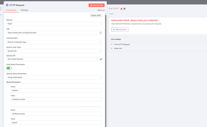

How do I setup Oauth credentials in n8n? When I create generic OAuth 2 credentials I get an error:
Full message
401 - "{\"error_message\":\"Valid [OAUTHTOKEN] is required for processing the request.\",\"error_code\":2401}"

Hi @King_Samuel_David thanks for your suggestion. I am not using Zoho Node, since that one supports just Zoho CRM Scope (we need different scopes for other services).
Problem with manual HTTP request is that the token needs renewal and we need Zoho Auth to refresh the token automatically. Your solution would work with static token. for an hour or so.

Hi, just want to shed light on this. So you won’t be able to get it work with oauth2 in n8n. I have tried the Zoho Mail api which had the same issue. The output of the Zoho API isn’t what n8n expects so after 1 hour it stops no matter what.
A work around that would work is to use multiple nodes to refresh the token and then save it.
Thanks guys! I could not get it to work so I created new n8n node with Zoho compatible OAuth
