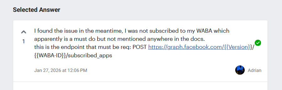

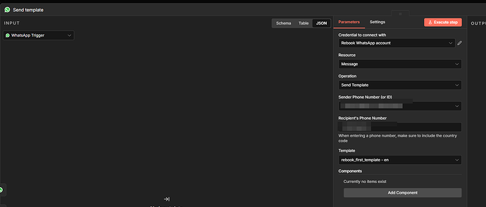

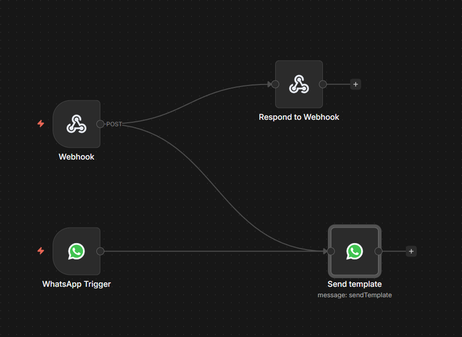

Please, I’m having an issue with my WhatsApp (Meta) and n8n integration.
I’ve successfully connected Meta to n8n using the correct credentials, and when I trigger the Send Message action from Meta, the message is delivered to my WhatsApp number without any issues.
However, when I reply to that message from WhatsApp, n8n does not receive anything. The workflow just keeps listening, but no incoming message ever enters the trigger.
I’d really appreciate help understanding what could be causing this and how to fix it. Thank you.
Hello @Teab_Teab Just to clarify one important point: for n8n to receive replies from WhatsApp, the Webhook must receive the exact payload structure defined in the WhatsApp (Meta) Webhook documentation.
Have you already configured the webhook and payload according to the official WhatsApp Cloud API docs for incoming messages?
Sending messages via the Meta node working correctly usually means credentials are fine, but receiving replies depends entirely on the webhook subscription, event types (messages), and payload format.
