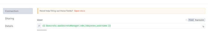

I have connected to my AWS secrets and able to refer those in my n8n credentials section. but unable ti view what the data it has retrieved, as the flows are failing i would like to view the details that has been retrieved from AWS secrets. Is there a way we can do that in n8n cloud

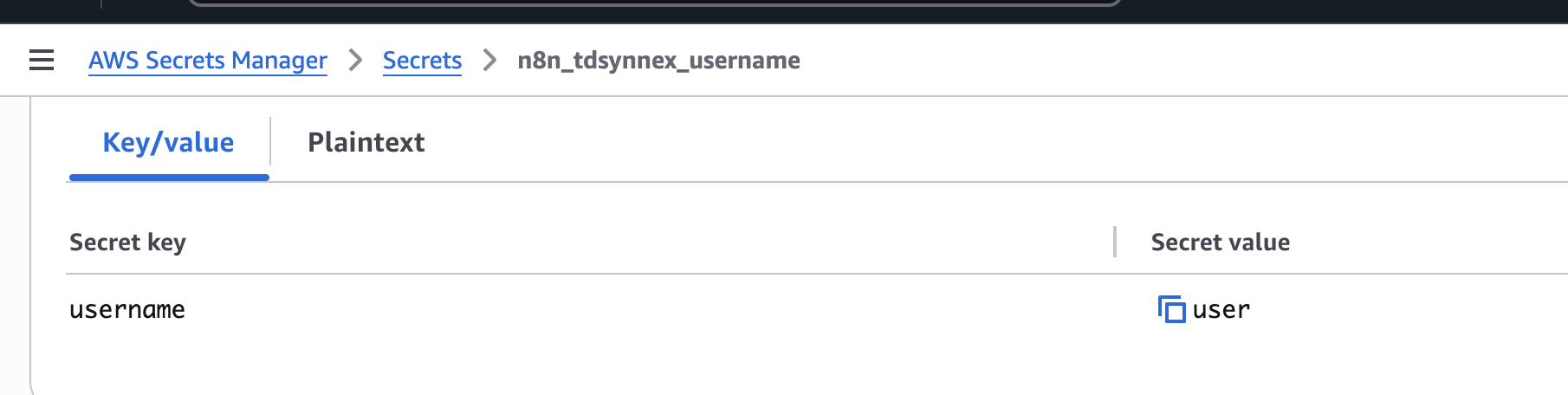

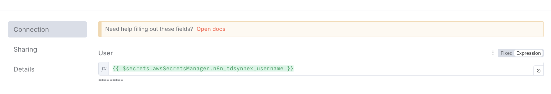

Here is my secret in AWS secret manager, how can access it. I am able to read that value, but how to view what value it has read. when i using the credentails it’s giving me the error..

As per n8n, we are able to read the secrets only in credentials. After reading the credentials there are by default masked. How do i view that secrets in code node, can you please share the sample code

No you cannot access the $secrets variable through the code node.
You can’t view the secret inside of your n8n instance. Only in your external secrets manager
