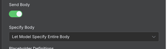

I’m trying to set up an AI agent, which should dynamically construct a JSON in a specific schema and then parse it to the “Search Database” tool which does an HTTP Request. The configuration for the Body is:

You could define this JSON in the description of the input.
Sorry, I’m not following. I tried specifying the JSON in the description of the “Search Database” node but it didn’t work.
Can you possibly show me an example where this is done and the AI Agent handles queries dynamically in such a way through sending a dynamic JSON in the Body?
Thanks,
Provide an example of the JSON queries in the http tool description or the description of the json body itself (should be a “add description” button), the model doesnt know what JSON params are allowed, so plainly allowing it free reign will cause issues.
