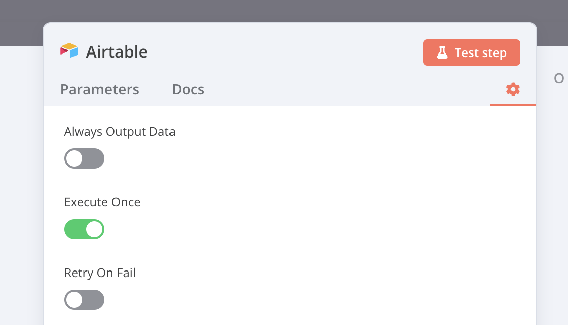

Hi @blueberry, thanks for reaching out! We have the execute once option available for many of our nodes.
This is also true for Airtable:
Let me know if you still need help adding the attachment to all of the items you referred to or if this helps you onto the right path! Happy building!
@Ludwig maybe I misunderstand how that setting work, but I’ve read that its only going to run once for the first item, which to my understanding if 20 items go into the Airtable node, only the first will get the attachments?
It depends on the desired behavior of the Airtable node, to be honest. Do you mind sharing your workflow (or at least the areas that you are interested in focusing on) and I can point you through it?

I ran a test with the “Execute once” option, and from 40 input items, only 1 was processed.
