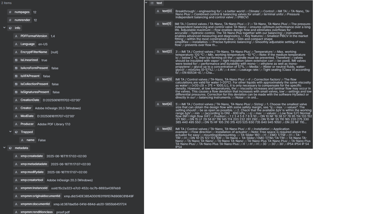

Hi,
I’m building a RAG agent and creating a workflow that lets me upload multiple PDFs to Google Drive (in this case, I tested with two). In the RAG pipeline, the data should be split into chunks and tagged with the correct file name from Google Drive. The idea is that it should work regardless of how many PDFs I add (sometimes one, sometimes several).
The first three nodes in the pipeline work as expected. The issue is with the “Extract from file” node: it extracts two items, but they both end up with the same title. When I use the output of that node later (in the Code node and Supabase), only one PDF’s information gets saved.
What could be the problem?
This is the output from the “Extract from file” node:
2 items
numrender
12

version
5.3.31
Hi,
As you can see on the attached image, the “Download file” does get both of the file names.
Is it possible to keep unique file names with “Extract from file” node or I need to adjust the code to get it from the “Download file” node?
Thanks.
P.S. This is what I get as outcome from my current “Code” node (2 items but one fileName and one fullText - don’t mind the pageNumber).
Should I put a for loop node or something on after “Extract from file” node, because I only see information about one of the PDFs (image below it the output from it)? Does it only go file by file?
