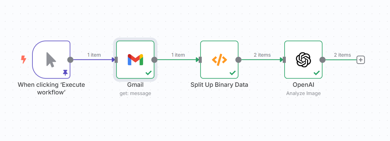

Hey @Acespade ,
Look I have sent the test email like below with 2 inline images
  • For demonstration purposes, Instead of gmail trigger I am just getting the email content using id. (The structure of output is same for both the nodes so no worries.)
  • Here is the demo workflow (I have pined the data so that you can see how it works) in on order to check the same on your side simply unpin the data.
So the outcome is that, still even if the images are attached as inline image, the n8n can easily download them if we turn on the download attachment option
  • Then simply I split the attachements/images and pass it to open ai node one by one and rest you can see in the workflow.
Thanks for this, but are you able to achieve the same for Outlook?
Because when I turned on ā€œdownload attachmentā€ option for Outlook, it does not detect any attachment for these inline images.
@Acespade , I don’t have access to the outlook account to test this at the moment…
But I feel it should work,
Have you tried download message attachment node of outlook?
Please let me know…if it works for you…else I have to create an account on my side, do some testing and get back to you!
Yes, trying download message attachment node works. Thanks
So, unlike Gmail, Outlook requires a chain of Outlook nodes to extract the inline images.
