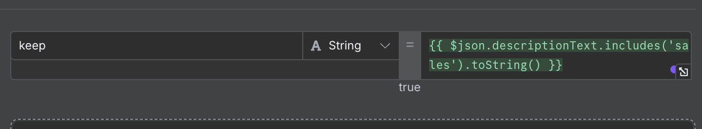

If you just want to “augment” the items and keep all of them, you could pass everything through a Set Edit Fields node and just add a derived field to each item, using an expression, like this:
Using a Filter node shouldn’t disrupt the item linking. Are you saying you tried that and it wasn’t mapping correctly?

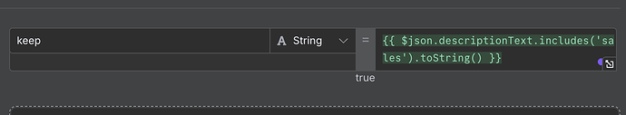

I think the code is ‘includes’, i tried ‘contains’ but it didn’t work
{{ $json.descriptionText.includes('sales').toString() }}

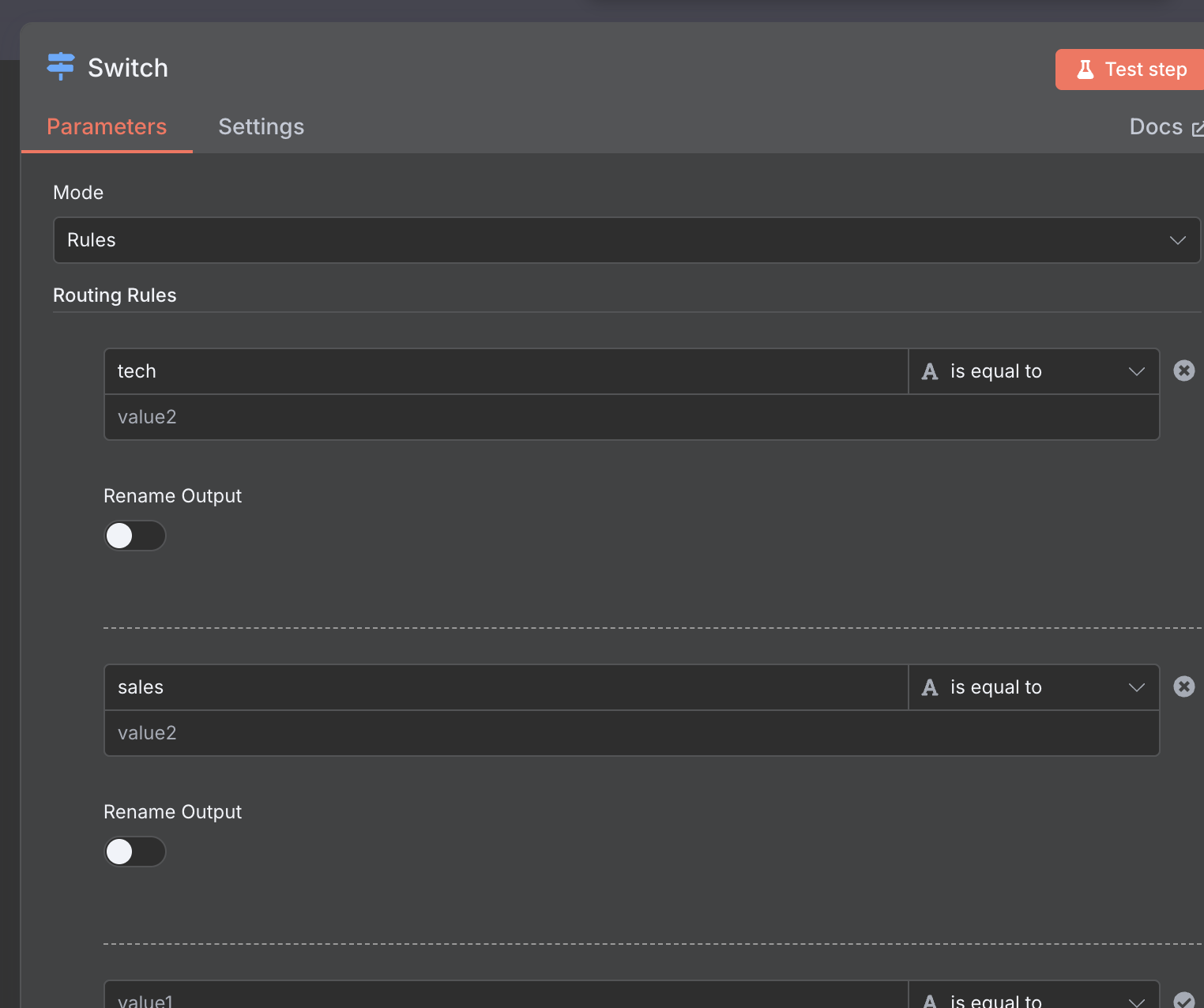

You could also use a switch node I like too, just depends :slight_smile:
