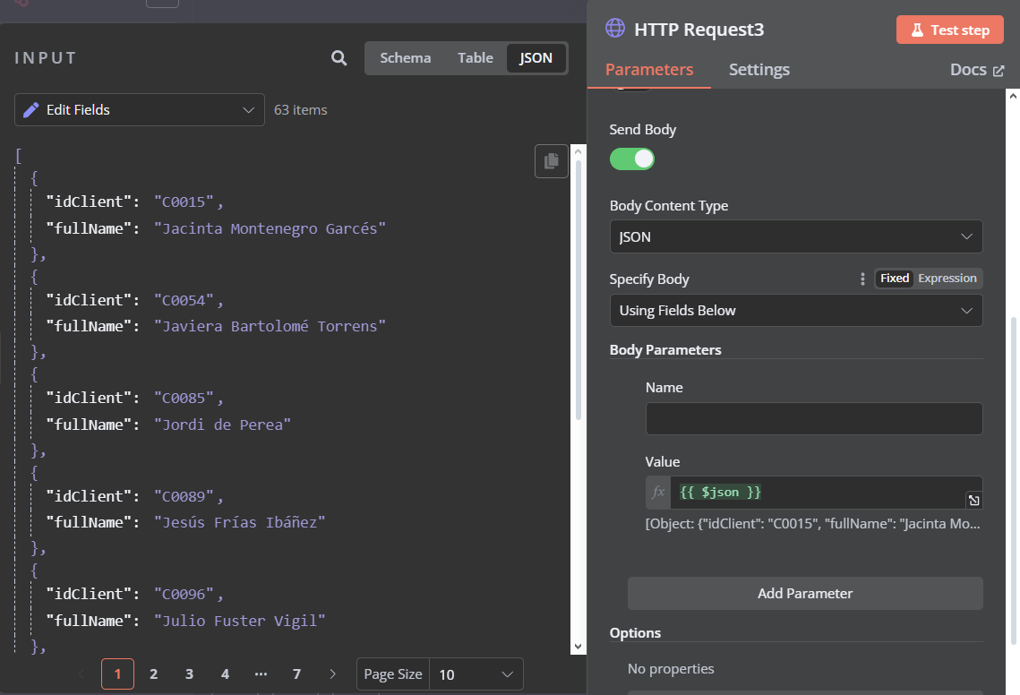

How to get rid of the "Object" part of this JSON: [Object: {"idClient": "C0015", "fullName": "Jacinta Montenegro Garcés"}]
I am currently processing some information from some xlsx to JSON when I try to send that JSON in this HTTP Request Node:

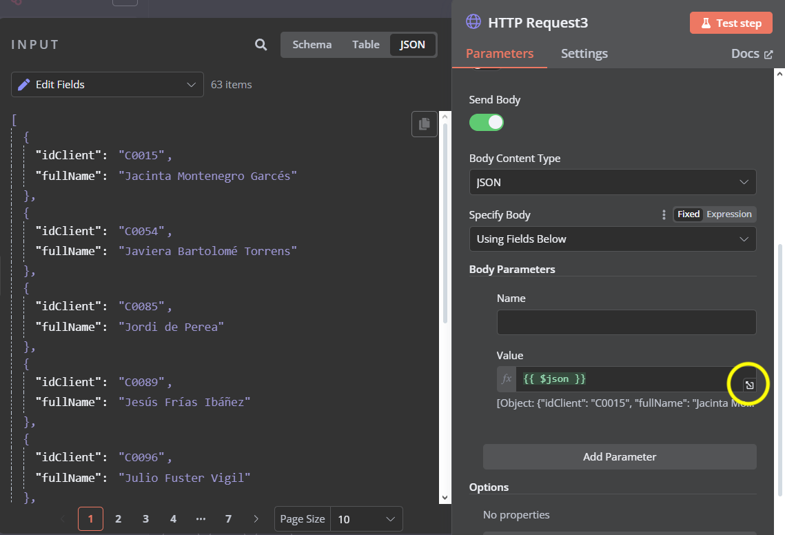

You can see that the JSON that I am trying to send is putting “Object”: right before the list of objects, how can I get rid of that object
  • **n8n version:1.77.3
  • **Database (default: SQLite):SQLite
  • **Running n8n via (Docker, npm, n8n cloud, desktop app): Docker
  • **Operating system: Windows

It symply shows the structure (schema) of the data, it is not what the actual data is. You can see the actual data by clicking on the image shown below
Though you likely need a stringified value rather then the object, in which case you can use {{ JSON.stringify($json) }}
