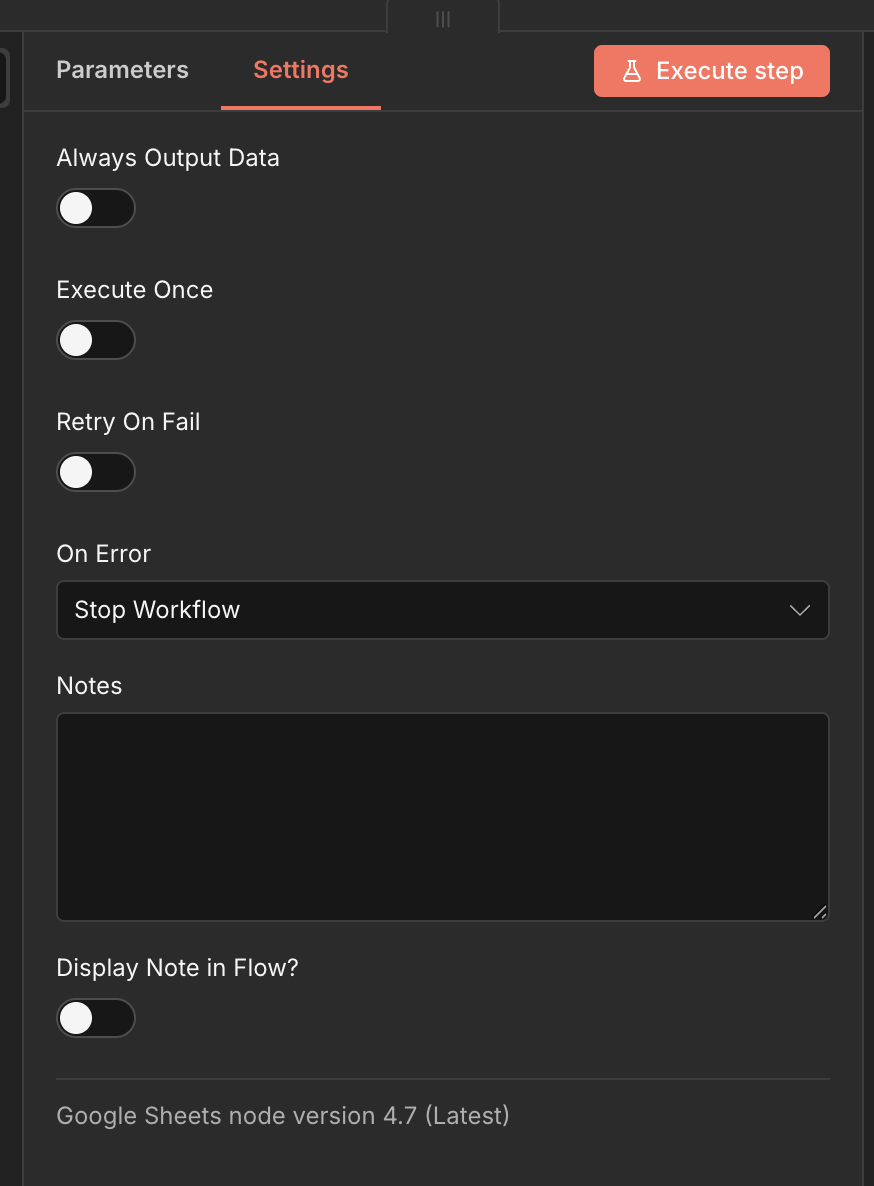

It will be useful to see what your workflow looks like to give more detailed recommendations, however you can look at the Settings tab of any of your critical points of potential failure for nodes and set these settings accordingly to avoid your workflow from falling over
For example Retry on fail is useful to mitigate any network issues which might happen

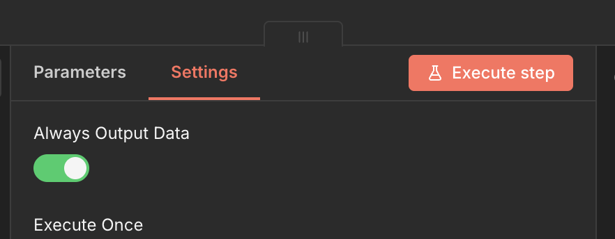

Always output data is useful for nodes (usually db nodes) returning nothing when no records are found, causes the workflow to stop processing. Enable this to continue with a null to the next node

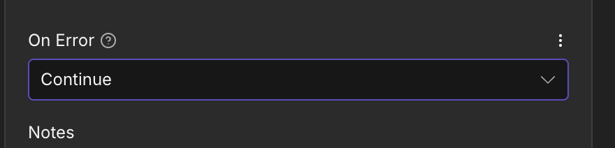

On Error continue is useful for ignoring failed node executions and continuing. This is useful when it doesnt matter if some records failed and you want to continue, for example processing batch operations

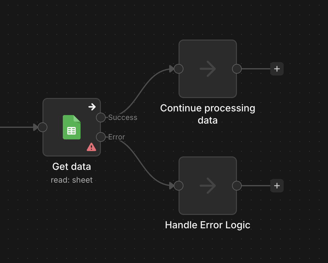

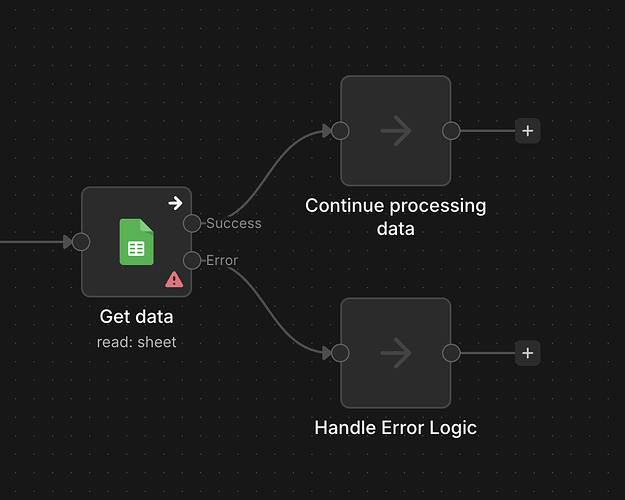

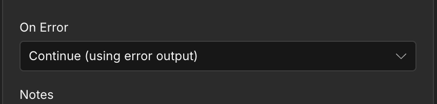

On Error continue with error output adds an additional error output path for the node, which allows you to continue processing your workflow and handle logic in cases of errors.
