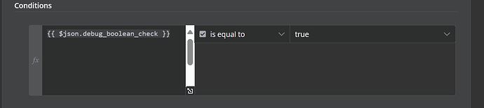

Your workflow:
I can’t test as I don’t have access to your SQL side of things, but the edit fields after the SQL is setting a string, but you’re comparing it with a boolean. In other words, this:
is where you’re setting it as a string, but this:
is where you’re comparing it as a boolean. Have you tried setting a boolean instead of a string?

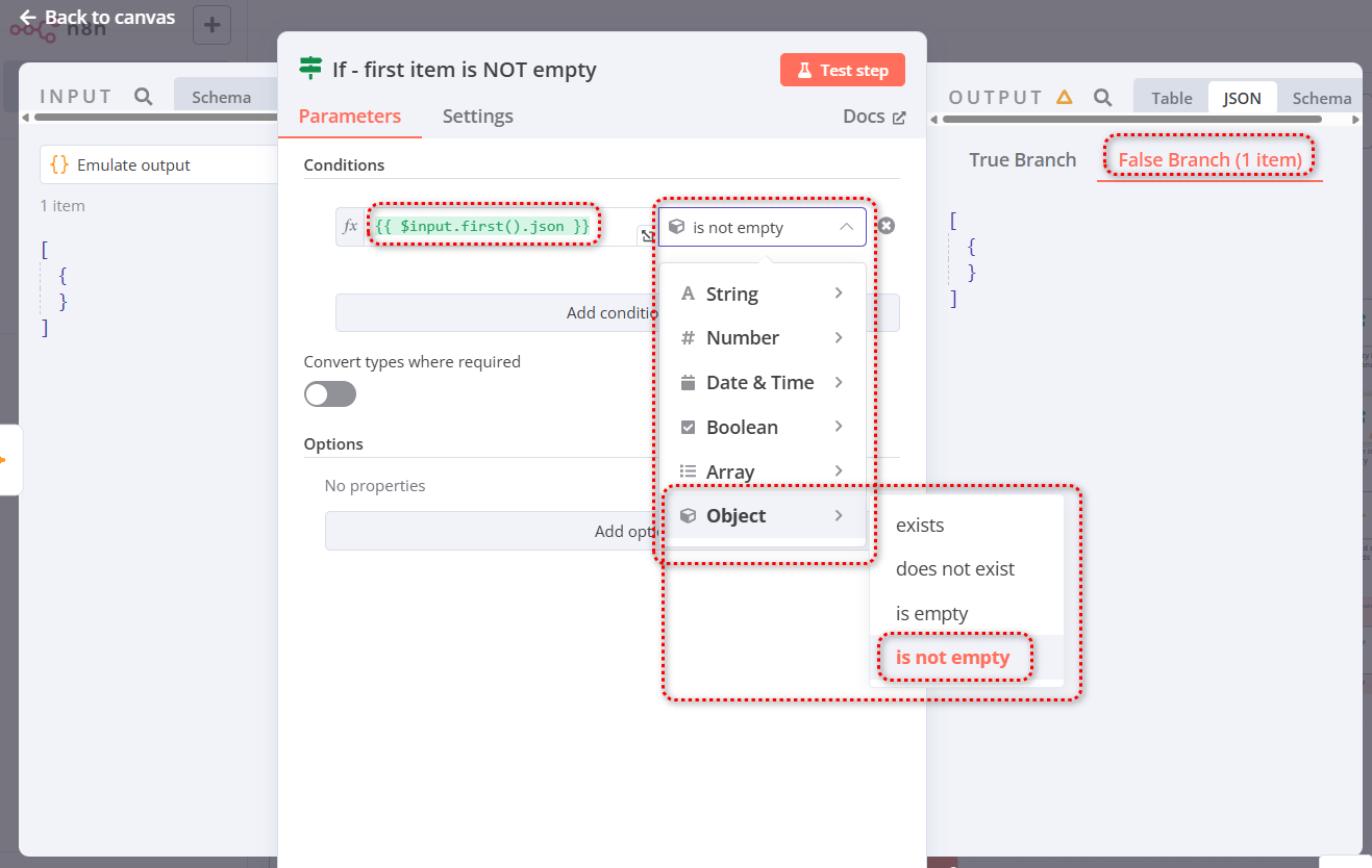

Looking at the “Edit Fields1” node expression {{ Array.isArray($json) && $json.length > 0 && !($json.length === 1 && JSON.stringify($json[0]) === '{}') }} I think I understand where the issue comes from.
$json can never be an array as it represents a non-binary data object of one item in the node’s input array (which is, in its turn, an output from the previous node).
My hypothesis is that MySQL node returns a list of meaningful records (each represented by an object and referrable to as $json) if SQL query returns any results, or a list comprising single empty object (also accessible via $json) otherwise.
If my hypothesis is correct then the following should solve your problem:
Attach an IF node to your MySQL node with a condition
{{ $input.first().json }} Object=>is not empty.
Here
  • $input refers to the entire input which is an array of entries
  • .first() returns first element from input
  • .json returns actual data we want. In your scenario this is an object representing one (out of possibly many) record or no-matching-results-situation in a form of an empty object.
Please refer to the docs on n8n peculiar data structure:
I personally do not like this solution tho (because the IF node will iterate through all records, one by one just to put them all on true output branch).
Below is a playground to try different approaches under various scenarios. My preference would be “Aggregate and cleanse records” in the playground below.
Why? As an output from the Code block we have a scoped property that would contain array of records (empty if no records are returned from the DB). To me, this is a more explicit approach vs one when an empty object represents no-records situation.

Actually, we managed to figure out this, it seems that the IF node has a “Convert types when required” might cause an issue so we might implement this accidently :slight_smile:
Here’s the updated one, and worked well
