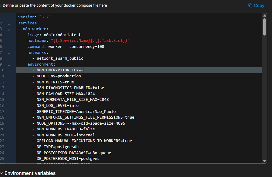

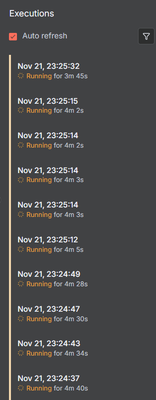

I’m trying to increase the number of simultaneous executions a workflow can perform, but it seems to only show 10 or only execute 10 at a time; I haven’t quite figured out this part yet.
I’ve already increased the replicas and the concurrency, and it still only shows that 10 are being executed.
I’d like to know how to increase this limit. Does anyone have any suggestions?
I’m using Docker + n8n version 1.120.4

Hey @Parintele_Damaskin
I’m using concurrency 100, but even so, only 10 executions per workflow are showing up.
Do I need to do something else?
Read again my post.
It doesn’t matter what have you set for the worker, if the N8N_CONCURRENCY_PRODUCTION_LIMIT that is a global variable, IF not set will go default to 10 worker concurrency.
