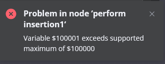

Hi guys, currently I’m working on a “database chat”, I’m downloading a CSV file from Google Drive and then insert the data into postgres database, this is working fine however, when I increase the number of data I got an error related to exceed the number of variables
Error message:
Problem in node ‘perform insertion1‘
Variable $100001 exceeds supported maximum of $100000
My workflow to insert the data, this error message is returned by the last node
The output returned by the last node:
Failed query: INSERT INTO ai_table_ventas_contado (“idVenta”, “monto”, “pago”, “fecha”, “idCliente”, “idUsuario”) VALUES ($1, $2, $3, $4, $5, $6), ($7, $8, $9, $10, $11, $12), ($13, $14, $15, $16, $17, $18), ($19, $20, $21, $22, $23, $24), ($25, $26, $27, $28, $29, $30), ($31, $32, $33, $34, $35, $36), ($37, $38, $39, $40, $41, $42), ($43, $44, $45, $46, $47, $48), ($49, $50, $51, $52, $53, $54), ($55, $56, $57, $58, $59, $60), ($61, $62, $63, $64, $65, $66), ($67, $68, $69, $70, $71, $72), ($73, $74, $75, $76, $77, $78), ($79, $80, $81, $82, $83, $84), ($85, $86, $87, $88, $89, $90), ($91, $92, $93, $94, $95, $96), ($97, $98, $99, $100, $101, $102), ($103, $104, $105, $106, $107, $108), ($109, $110, $111, $112, $113, $114), …
Anyone else facing the same issue?
How can I increase the number of supported variables?

hello @Juan_Noyola
Split query into batches and send batches instead. E.g. send no more than 1000 rows at once
Got it! Let me try splitting that query, I’ll post the results. Thanks!
