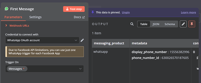

@HadiAbu i am unable to locate the pin the data.
i can only found “copy to editor” , due to i want to save cost , i host at repo cloud. can share with me how to reuse by pin ?
When you double click on any node you want the data to be saved.
the edit node view comes up (your second screenshot)
You need to be in the edit mode (not the execution mode) in order to pin data after you test it.
Steps:
  1. in edit mode/testing mode (not executions view)
  2. test workflow once with real data.
  3. go to the node that you’d like to keep the data.
  4. double click the node
  5. top right corner of the screen there is a pin icon
  6. click to reuse the data for every new test run
this is the view you should get after you click it,
@HadiAbu Thank you very much . Now i understand how to make use of pin . This will speed up the time and enable me in trouble shooting step by step.
