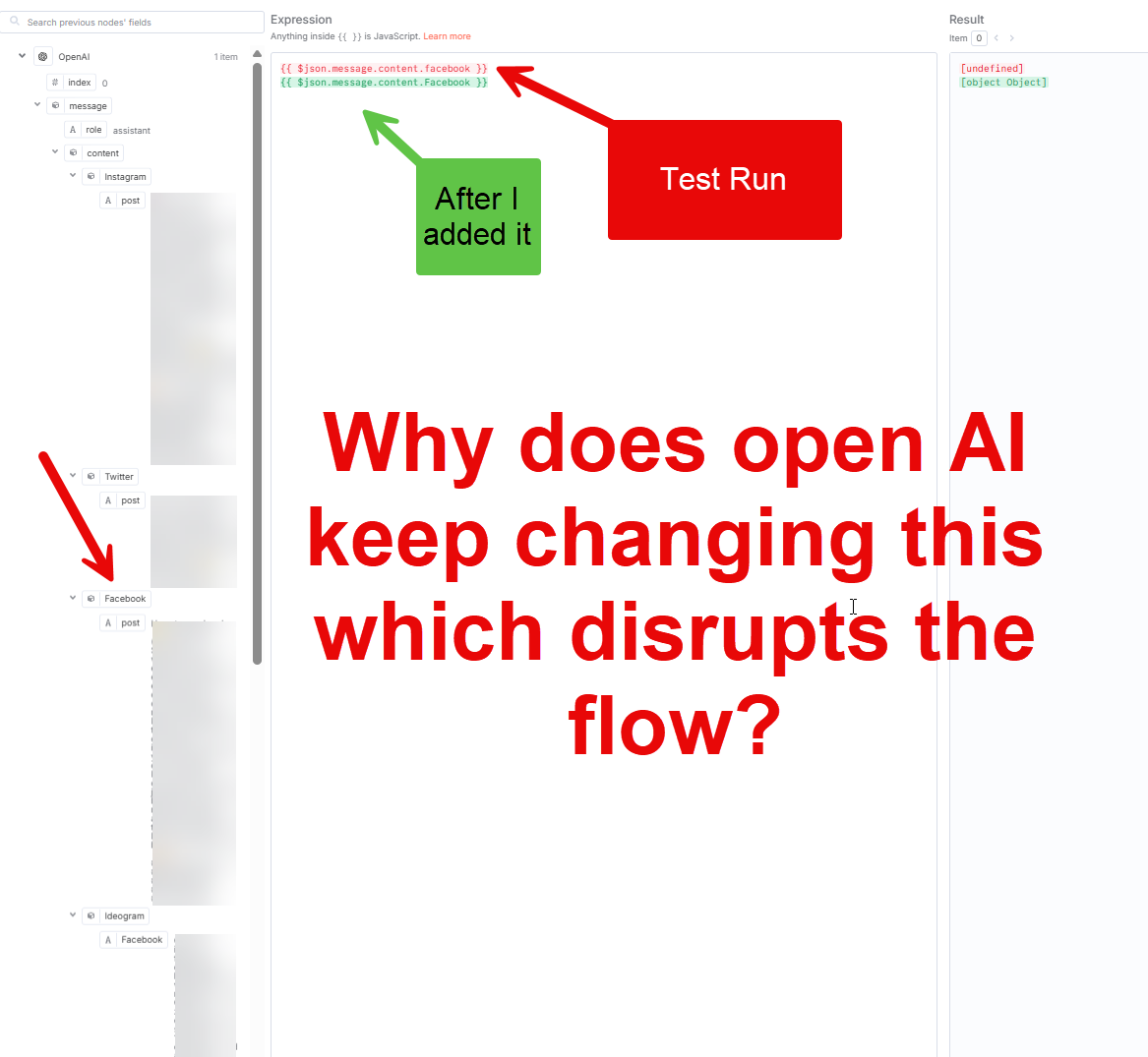

Open AI keeps changing the anchor capitalization, which causes errors in the workflow.
hello @jasonmbd
Why not use the Capitalized version?
Or both of them: {{ $json.message.content.facebook || $json.message.content.Facebook }}

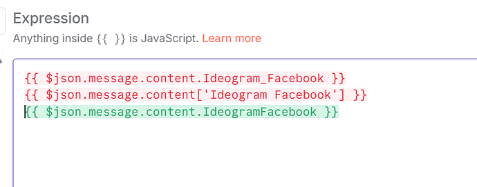

I could but the issue is bigger than that. It keeps changing and I need it to stay static for every update. How do you make it so it does not change?
See this example. 3 different variations of the same thing:
