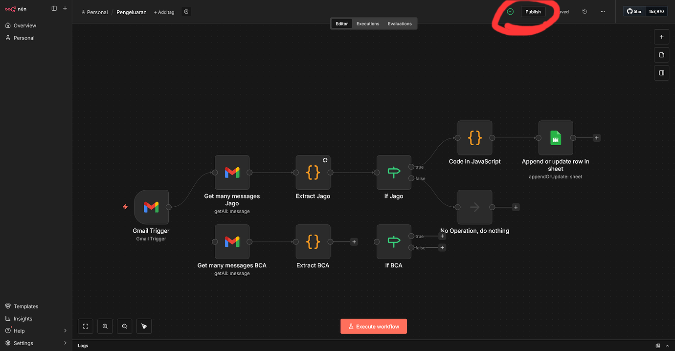

i just started using n8n today to get my expense to sheets, currently its self hosted on docker. event on gmail trigger is “message received”. So how do i make it always running? i saw some people has “active” on top but i don’t have it. I also sent 2 email previously but it doesnt read it
workflow file

Since you are using newer version that mine, I think the UI has changed.
What you have seen in videos, yes I have the “toggle active” button.
Now it’s “Publish” as you can see innsame spot.
And , yea, you should keep your PC on .

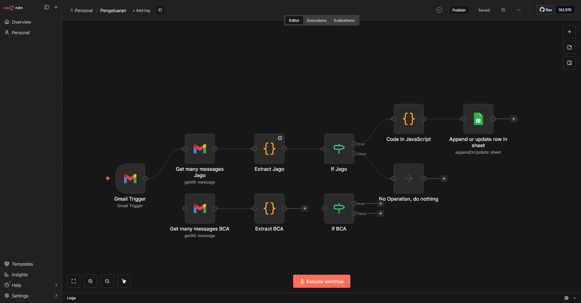

i tried reconnect my gmail credentials and sent 1 email and it still not reading new email. i’ll try remove all credentials and add them again later
  1. I did publish and execute before sending those emails
  2. I just found out that latest version(which i use) replace active with publish
    also workflow runs normal manually but not while it “running“ or published

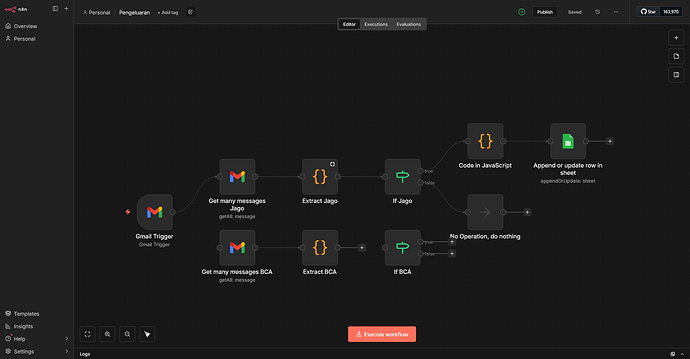

Its working now, i had to delete “get all message node“ and gmail trigger goes to code node
