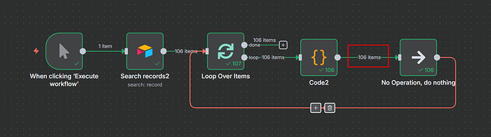

I have a workflow that retrieves 106 items from Airtable and needs to process them one by one through the same sequence of nodes.
I tried using the Loop Over Items node with Batch Size = 1. As a result, the loop:
  • Accumulates all processed items and passes them forward (1 → 2 → 3 … items), which eventually causes memory issues.

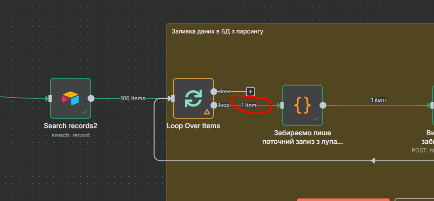

    So there what i need

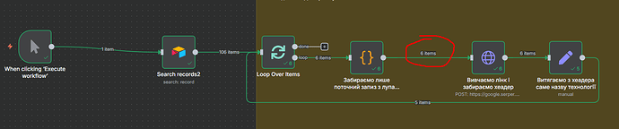

And here is what I got when start execution
As you see each time it send me all previous items +1
Thanks in advance for any suggestions!

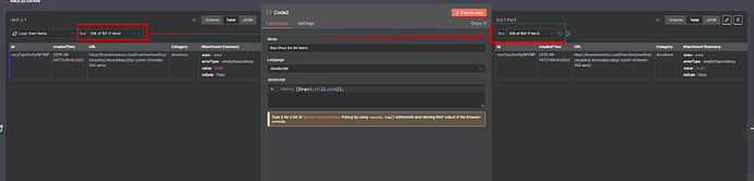

If your code node is accumulating the results into one output item, then this is how you coded it. What does your Code node do?
In this node I am trying to create code that will delete everything except the last item.
So that there are N items in the input and only 1 last item in the output.
But I can’t figure out how to do it yet.
I think you might be overcomplicating the problem. If you need to get the last item from multiple items coming as input, this is the code you need:
return [$input.all().pop()];
Here is a simple example:
Nope, its not working.
106 items at input and 106 at output
Well it did pop one item 106 times, because you are doing it in the loop, one item at a time. If you don’t need all 106 items
then you don’t need the loop
