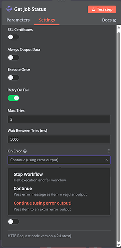

I noticed you have a Wait node for ā€œPENDING.ā€ Have you tried adding another Wait node for ā€œERRORā€ to wait for 30 minutes?
Also, I think you’ll need to update the HTTP node settings under ā€œOn Errorā€ to ensure that the workflow does not stop when an error occurs.

Maybe you could redesign the workflow so that in case of failure, the file is moved to a ā€˜failure folder.’ Then, set up another workflow that triggers every 30 minutes to move the file from the ā€˜failure folder’ back to the main workflow folder, thereby restarting the process…
