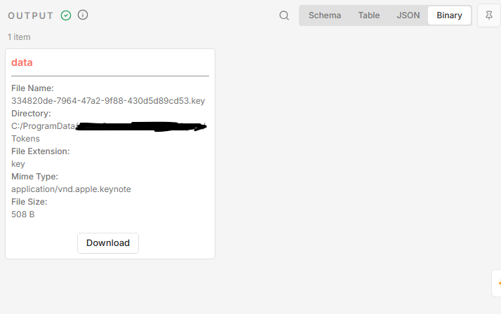

This is the output binary data from ‘Read/Write Files from Disk’

@shakthipsg Now attach an Extract from File here, and then read your key using common json.data and then pass that key to HTTP node where you want it to be.
Thank you @achamm @Anshul_Namdev , This works.
